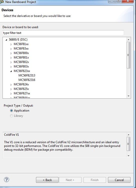

Is the MCU MC56F82323 supported in codewarrior 10.6?
I can find MC56F82313 and MC56F82316 but not the above when creating a new project (see the picture)
Thanks!

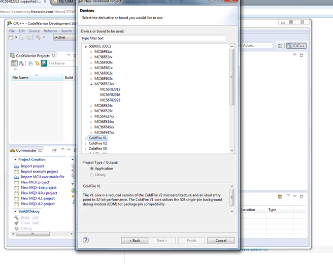

!Hi,
I don't think you're using the last version which is CW for MCU v10.6.4 + Patch 10.6.5.
I've checked on my side and the 82323 is listed :

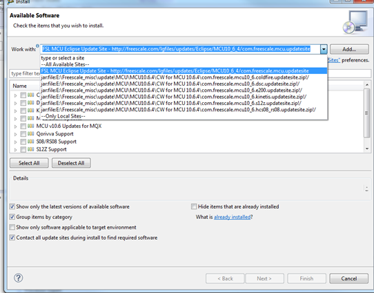

Just another point.
After to have installed the MCU v10.6.4 on new folder (you can keep the older versions too), when you will launch Eclipse, after some time the system will propose you to download and install automatically the patch.
If it's not the case you can check it via Help + Install New Software ...
At field Work with select
    FSL MCU Eclipse Update Site - http://freescale.com/lgfiles/updates/Eclipse/MCU10_6_4/com.freescale.mcu.updatesite
If you've problem let me know.

agf
Ok,
you're right!
I've installed the patch and now i can see the MC56F82323!
