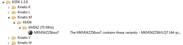

I try to build an CW project for MKM34Z128 MCU, but no Process Expert available for the project,
when will add this MCU to Process Expert?

Hi Sam,
CodeWarrior support for Kinetis is frozen. All new development goes into Kinetis Design Studio (http://www.freescale.com/kds) and the Kinetis SDK. KM34Z128 is supported in KDS v3.0.0 'bare' (no Processor Expert, no SDK), but the KM34Z256 is supported with Processor Expert:
So ultimately it is not about if CodeWarrior or Kinetis Design Studio supports something: the question is if the Kinetis SDK supports it. If the Kinetis SDK supports it, it is automatically supported by Kinetis Design Studio. Therefore I recommend that you migrate to Kinetis Design Studio for any new devices, as new devices won't be added to CodeWarrior. They will be in the Kinetis SDK and Kinetis Design Studio.
