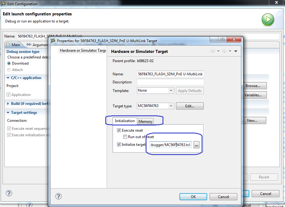

Problem with CW10.5  he used 56F8323 with CW classic and his project worked great.
  After upgrading CW t o10.5(10.4 and lower don't support import  from CW classic) during debug MCU flash is not initialized,
but if  customer use programmer mode everything works ok.   Debug probe is USB-TAP.

Would you please create a new project for your target from <File> menu -> New->Bareboard project, can CodeWarrior v10.5 program with this project into your project?
If it can, please compare its debugger settings in Project Properties with your project, especially whether the initialization file and memory file are selected correctly.

I had a similar problem with the USBTAP, and after adding the tcl file location as Fiona noted and updating the memory file too, it started to work good. Try it

The same options are also there in Multlink connection settings.

Everything is done. The problem remained.
