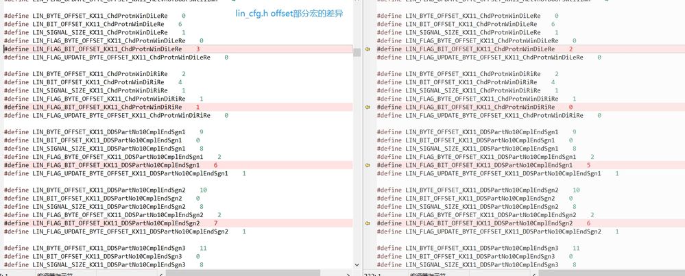

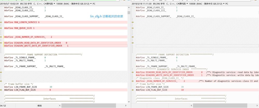

Compared with the code generated by ncf_tool, it is true that the bit_offset has been updated and that there have been changes in the diagnostic section.
Compared to the driver source code, a lot of MCU macros have been added, the "{" position has been changed, and the diagnostic section has been modified a lot, as well as other changes. However, I did not see the relevant instructions for the specific change of curriculum vitae.

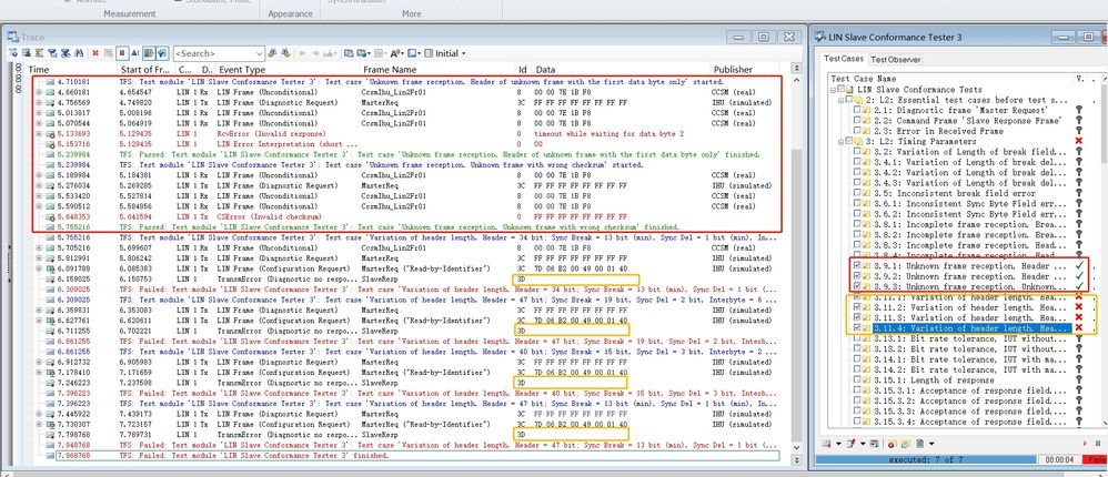

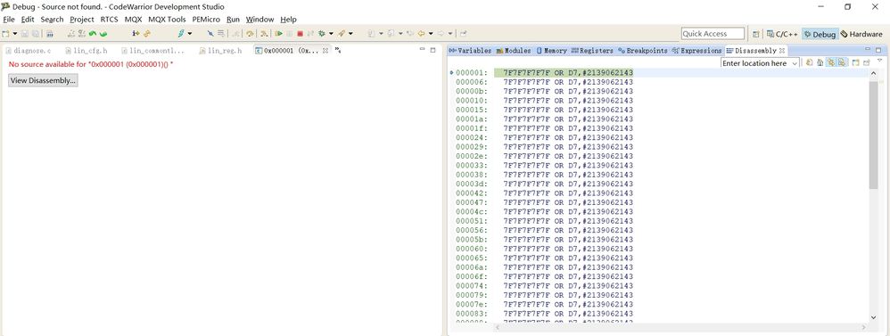

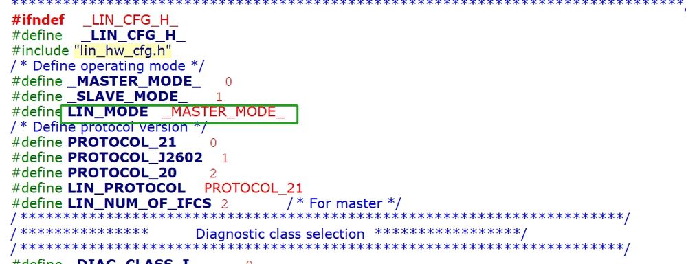

There is now a project that needs to be configured into a two-way LIN slave node mode. You can generate code through the ncf configuration tool, and you can see in the lin_cfg file that there is a definition defined as _ SLAVE_. in the MASTER_MODE,lin_ifc_configuration Then there is no problem with the use of the two LIN and the reading and writing of unconditional frames. But I now need to do LIN slave node conformance testing.
When testing and debug from the node consistency test script provided by the CANoe, the single-chip microcomputer will prompt the "No source available" as long as any one is executed,
Then I also tried, only using IG to simulate sending is also No source available.
I've tried with both 4.5.1 and 4.5.9 drivers, and LIN, configured to two slave nodes is No source available, but there is no No source available problem with LIN, configured all the way from the node. And CANoe can pass most of the test cases in the conformance test script of the node.
The problem will be more serious because the single-chip microcomputer had an unexpected "crash" and finally was reset by the watchdog to resume normal unconditional frame communication.
So when you recognize the configuration of the two-way slave node LIN, are these slave node conformance testing related diagnostic services already supported?

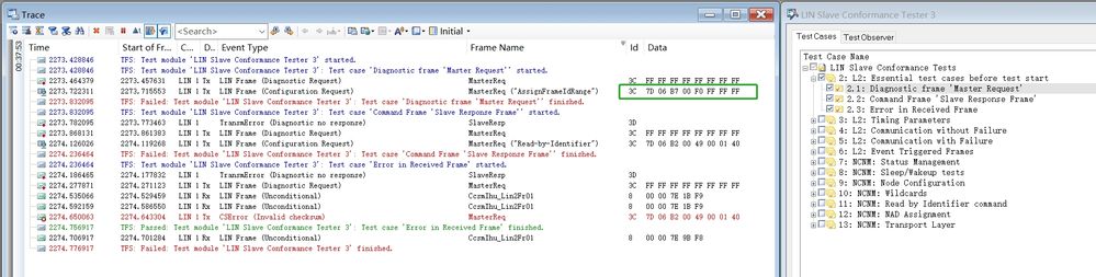

      But for the question3, I need config 2ch LIN slave for application. I try to use NCF config the driver and there is no problem with the use of the two LIN and the reading and writing of unconditional frames.But I cannot pass the
Conformance Test of LIN.
      Here is my config for diagnostic service:
/****************************Support SID Initialization ***********************/
const l_u8 KX11_IHU_lin_diag_services_supported[_KX11_IHU_DIAG_NUMBER_OF_SERVICES_] = {0xB2,0xB7,0x22,0x2E,0xB3,0xB0,0xB4,0xB6};
l_u8 KX11_IHU_lin_diag_services_flag[_KX11_IHU_DIAG_NUMBER_OF_SERVICES_] = {0,0,0,0,0,0,0,0};
const l_u8 KX11_CCM_lin_diag_services_supported[_KX11_CCM_DIAG_NUMBER_OF_SERVICES_] = {0xB2,0xB7,0x22,0x2E,0xB3,0xB6,0xB4,0xB0};
l_u8 KX11_CCM_lin_diag_services_flag[_KX11_CCM_DIAG_NUMBER_OF_SERVICES_] = {0,0,0,0,0,0,0,0};
   The 0x22 service can get response bue  the 0xB2/0xB7 can not get response.CatchA939(05-17-09-30-20).jpg
   I want to know the new version of the lin stack for 4.6.1 can support config 2ch LIN salve at same project and the diagnostic service can work for conformance test of LIN.

FelipeGarcia
The LIN Stack package is compliant to LIN 2.0 and LIN 2.1 / 2.2a specifications. You can find this statement on the release notes.
Also, I known limitation is that conformance test coverage 99.06%.
