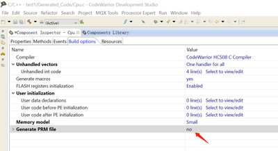

I'm able to add a checksum for my mc9s08aw60 but I can't make it permanent.
I was able to generate the checksum by adding my setting into "ProcessorExpert.rpm" but it's a generated file so each time the project is regenerated, the settings are lost.
Here is my checksum setting:
CHECKSUM
  CHECKSUM_ENTRY METHOD_ADD
    OF READ_ONLY 0x1860 TO 0xFFAD
    INTO READ_ONLY 0xFFAE SIZE 2
    UNDEFINED 0xff
  END
END
I'm not able to find in the help file where to add this to make it permanent.
Any idea ?
Thanks.
1,866件の閲覧回数
ZhangJennie
Processor expert can't configure checksum in prm.
If you need this feature, we have to disable prm generation to avoid being overwritten. then you manually configure prm file by self.
