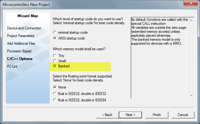

ZhangJennie
if the non-paged memory size is enough for your code, you needn't use paged memory. otherwise, it's necessary to use paged memory.
when use paged memory,  we need choose banked memory model:
we have an3730, an3730sw covered this topic. see:
http://cache.nxp.com/files/microcontrollers/doc/app_note/AN3730.pdf?fsrch=1&sr=2&pageNum=1
Software to accompany AN3730
can this help you?
Jennie Zhang

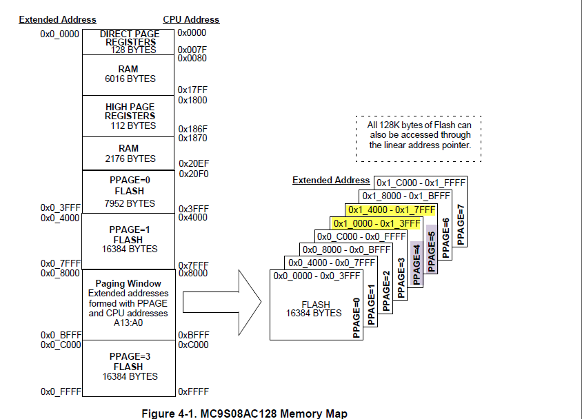

ZhangJennie
hi,
according to memory map, 0x10000 to 0x17fff is linear address for page4 and page5.
when use linear address mode, this range of memory address is 0x10000 to 0x17fff; if use page memory mode, the same memory is (0x048000 TO 0x04BFFF, and 0x058000 TO 0x05BFFF); user must choose one mode of them.
in banked memory mode, paged memory can be used for allocating code. code(function )  is inherently accessed by __far.  you needn't use #pragma for it.
however from what i am understanding linear address is only for data access. so you can't define all of the flash memory in linear address mode in prm file. code(function) must use paged and non-paged memory. data access can use linear address. see two demo code in an3730
Jennie Zhang

preetuabraham
Hi Zhang,
Whether the  memory range 0x10000 to 0x17fff is part of Paged memory and to use this I have to use banked memory model  or can use small memory model with MMU ?
3,349 Views
preetuabraham
Hi Zhang,
  For the above PRM file, memory range 0x10000 to 0x17fff is not mentioned ,Whether we can use part of paged memory model or as part of small memory model
Since for the calcualtion of CRC ,While reading s-record data for 0x10000 to 0x17fff ,it is nto able to calcualte CRC
So for the above PRM ,whetehr I can modify as following for the Flash memory and I need small meory after 0xffff

preetuabraham
Thanks Jennie for that information
After usign the Banked memory ,software uses some of the section PPAGE2 from the PRM file given above,but
whether for those variables which are getting allocation in PPAGE2 I have to use # pragma statement  for the memory to get allocated correctly. Also since those variables are getting allocated in PPAGE 2 ,in the above PRM File I have to move PPAGE2 to PAGED_ROM from DEFAULT_ROM and use pragma statement for PAGED_ROM.What exactly PAGED_ROM means
See the allocation in map file from PAGED_ROM

ZhangJennie
HI,
If you use banked memory model,
while data is accessed by __near. thus you need use #pragma to define variable in paged memory.
Jennie Zhang
