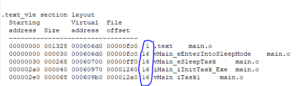

Can someone please tell me what this column is for in map file ?

It means how many bytes aligned.
