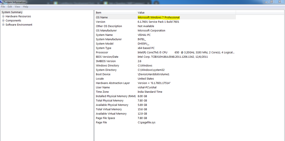

I am trying to install evaluation version of https://www.nxp.com/support/developer-resources/software-development-tools/codewarrior-development-t...
CodeWarrior for MCUs (Classic IDE)6.3
System Configuration:
Error: System is Windows7 64-bit, i5 intel with .Net 4 & DirectX already installed but still same error after running CodeWarrior for Microcontrollers (RS08HC(S)08-ColdFire V1) v6.3
Please suggest how to install the CodeWarrior for Microcontrollers (RS08HC(S)08-ColdFire V1) v6.3?

HI Vishal Aditya
CodeWarrior 6.3 doesn't support 64BIT WIN7.
For HCS08 devices, to work on 64bit win7, please use CW11 instead.

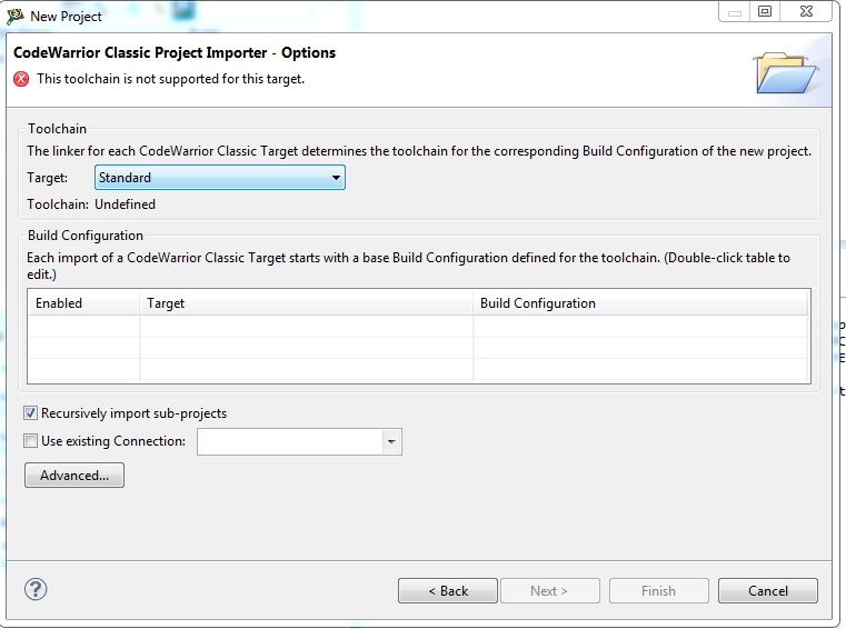

I have installed correctly CW_MCU_v11.1_b181224_PE_Offline.exe & trying to import CodeWarrior Project: Medical_ventilator.mcp
Please reply to how to install Toolchain?
