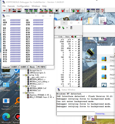

是这样的我安装了cw v2.10 ,它自带的PE Micro 看起来版本太低了老是显示无法进入后台
Here's the thing: I installed cw v2.10, and it comes with a PE Micro that looks too low and keeps showing that I can't get into the background
然后我在论坛看到说1.34版本太低要给它升级一下,然后我就去升级了最新的8.98版本,然后它说我硬件太旧让我以旧换新,这显然是无法实现的,然后我又另外找了5.12和7.59的版本,它们都有一个相同的问题:我输入install code 没有生成蓝色的registration code ,请问有人知道怎么解决吗?
Then I saw in the forum that version 1.34 was too low to upgrade it, then I went to upgrade the latest version 8.98, then it said my hardware was too old and asked me to trade it in, which is obviously not possible, then I found another version 5.12 and 7.59, they both have the same problem: I input install code and no blue registration code is generated. Does anyone know how to solve it?
这是别人的界面
This is someone else's interface
这是我的界面
This is my interface

升级版本后已解决

You can update your CW2.10 by reading this FAQ and getting the "Patch for Qorivva (PowerPC Nexus) Codewarrior"
https://www.pemicro.com/faqs/faq_view.cfm?id=211&menu_id=faqs
这是PE官网的解答
https://www.pemicro.com/forums/forum_topic.cfm?forum_id=9&forum_topic_id=8816#c30821
