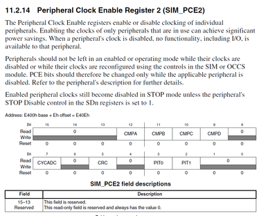

Using the MC56F83000x EVK with CodeWarrior IDE.  I have written simple program to invoke an ISR from PIT_0 timeout. I used Graphical Configuration Tool (GCT) to set up PIT_0 registers for priority, timeout and ISR linkage. But the ISR is never invoked I assume because the pitCntr is never incremented.  I can't see what is missing.  I could gratefully use some help. The main() and appconfig.h are shown.

I suppose that you do not set the PIO0 gated clock as the following figure in the SIM module. There is a clock enable menu in the QCT tools, pls check it.
If it can not solve your issue, pls update the ticket.

Yes, by enabling PIT_0 under System Support Control - Peripheral Clock Enable my ISR is now being invoked.
