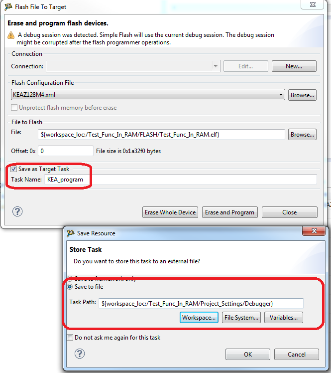

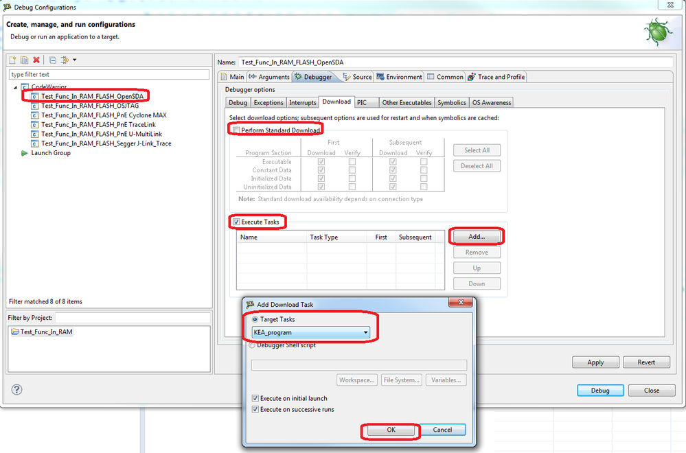

I reproduced the issue and it's indeed a defect.
I'd recommend you to use Flash Programmer instead and then connect to the device or use J-link Firmware as suggested by Alice as a workaround:
1) create a target task that programs the elf file to the device and save it to the project directory:
2) adjust the debug configuration so it does not use the default download but executes the target task instead:
3) apply and now if you press "Debug" you should always be able to program the mcu.
Hope it helps.

walter_wang
Dear Stan,
We've tried your proposal and it works well. Probably we prefer OpenSDA because we have no license available for J-Link Flasher.
