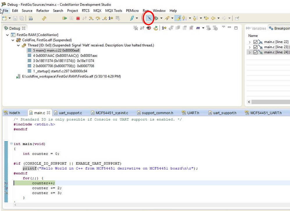

I'm using a PE Micro USB Multilink Interface module to connect to my target.  Also using CodeWarrior 11.0.0 on Windows 10.
I have been having troubles breaking at breakpoints, so I placed a break point in a loop.
When I invoke the debugger, the source comes up in the left window/panel and the debugger is sitting at right after main.   As you can see, I have three break point set at Line 22, 23, and 24.  The breakpoints are a Regular, Hardware, and Software.
So, at this point, I click on the "Resume" icon (green triangle just under "Run" in top menu).  Execution does not stop at the break point.
Any ideas on why I can't break at breakpoints that I set?

Hello Zachary Wilcox,
It seems you have disable all the breakpoints, please click the below button to enable it :
Hope it helps
