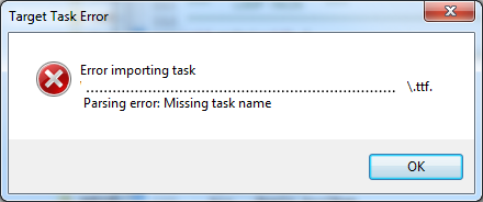

In CodeWarrior for MCU Version: 10.3, when start CW I have this error:
How can I delete it ?

Do you have a file with *.ttf (target task framework) in your project?
Remove that file (or rename the extension) might help.

FYI, a similar problem is described here: Error importing task? | MCU on Eclipse

Yes tanks
