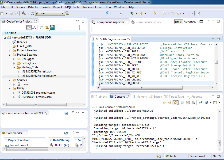

I built a project using CW v10.6 with MC56F82743, i did not use P&E mode. But i don't know where to modify the interrupt vertor. Do i need to import the interrupt vector.c manually? or built one?

If you do not use PE, there is a file MC56F827xx_vector.asm, which define the vector table, you have to add the ISR in the table.
for example, you define an isr in main.c
void QDCISR(void);
void QDCISR(void)
asm("nop");
in the MC56F827xx_vector.asm, you can write in this way.
section interrupt_vectors
    XREF QDCISR
    org    p:
    global    FMC56F847xx_intVec
FMC56F847xx_intVec:
;Interrupt                              ;Description                               Pri  VBA+  #
; jsr >Finit_MC56F847xx_ISR_HW_RESET  ;Reserved for Reset Overlay                      0x00  0
; jsr >MC56F847xx_ISR_COP_RESET        ;Reserved for COP Reset Overlay                 0x02  1
 jsr >MC56F847xx_ISR_ILLEGALOP        ;Illegal Instruction                       3    0x04  2
 jsr >MC56F847xx_ISR_SWI3             ;SW Interrupt 3                            3    0x06  3
 jsr >MC56F847xx_ISR_OVERFLOW         ;Hardware Stack Overflow                   3    0x08  4
 jsr >MC56F847xx_ISR_MISALIGNED       ;Misaligned Data Access                    3    0x0A  5
 jsr >MC56F847xx_ISR_STPCNT           ;EOnCE Step Counter Interrupt              1-3  0x0C  6
 jsr >MC56F847xx_ISR_BKPT             ;EOnCE Breakpoint Unit                     1-3  0x0E  7
 jsr >MC56F847xx_ISR_TRBUF            ;EOnCE Trace Buffer Interrupt              1-3  0x10  8
 jsr >MC56F847xx_ISR_TX_REG           ;EOnCE Transmit Register Empty             1-3  0x12  9
 jsr >MC56F847xx_ISR_RX_REG           ;EOnCE Receive Register Full               1-3  0x14  10
 jsr >MC56F847xx_ISR_UNUSED
 jsr >FQDCISR ;  MC56F847xx_ISR_UNUSED
Hope it can help you
