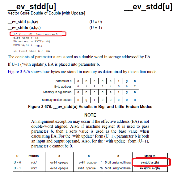

stanish
SPE/SPE2 instructions are described in SPE2PIM document available here:
http://cache.nxp.com/files/32bit/doc/ref_manual/SPE2PIM.pdf?fpsp=1&WT_TYPE=Reference%20Manuals&WT_VE...
The issue you observe is caused by the fact that  R0 has special meaning in most of store instructions - destination address is 0x0 instead of a real register value.
See the instruction description:
So the solution is easy - use other register then R0 as a destination address register
Hope it helps.
Stan

zhouxian
Hi .Where can I find the manual for the spe instructions like evstdd / evldd. I cannot get evstdd r4, 8(r0) to work when r0 points to memory area.  But it passes compiling and linking process.I use MPC5675K evb and booke instruction set.
