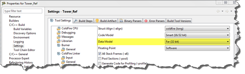

this means that the distance to the symbol/variable does fit any more into a 16bit offset. You need to change the 'memory' model of the compiler. Go into the project settings > ColdFire Compiler > Processor and select e.g. 'Far (32bit)' data model:
I hope this helps,

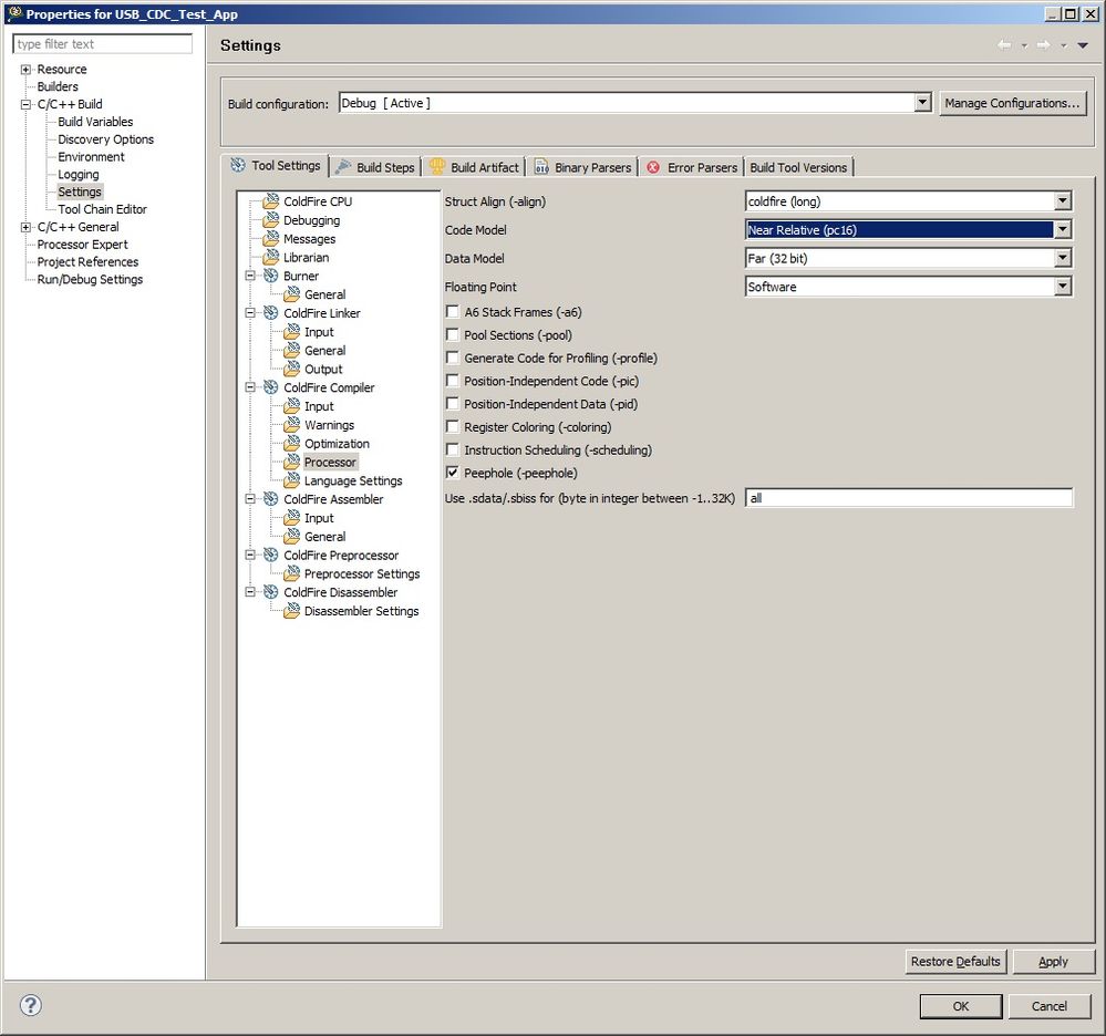

Hi Erich.  Thanks for the tip, but my project settings were already configured for the Far (32 bit) Data Model.  I tried changing the Code Model from Near Relative (pc16) to Far (32 bit), but it yielded the same results.  All of my projects (library and application) are using the same ColdFire Compiler Processor settings:
Any other ideas? :smileyhappy:

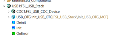

For MCF52223 only a warning comes as doing it differently:
_g_Mem(.usb_bdt) in file usb_dci_cfv2_c.obj is referenced but has not been written. Check your linker command file.
However, in MCF51JM there is an error.
Can I see step by step solution?
Marceli
7,299 Views
marcelifirlej1
Problem solved in component Help file and by disable PE build linker.
https://mcuoneclipse.com/2012/03/10/usb-or-not-cdc-with-processor-expert/
