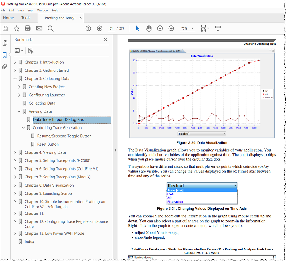

Does J-TAGE can enable Trace function in Code Warrior Development Studio?J-TAGE use more wire,why SWD can enable Trace but J-TAGE could not.I use J-Link debugger.And I want to know does Code Warrior Development Studio have Keil-like tracking function?Such as Logic analyzer.etc.Please help.

You can find the information: As shown above, the SWO trace pin is shared with the JTAG TDO pin. So this means that SWO cannot be used with JTAG, it only can be used with SWD in Tutorial: Using Single Wire Output SWO with ARM Cortex-M and Eclipse
Please check if Data Visualization is that you need(C:\Freescale\CW MCU v11.1\MCU\Help\PDF\Profiling and Analysis Users Guide.pdf)

By J-TAGE, do you mean J-Trace or JTAG interface? I haven't used the Trace of CodeWarrior, so it's not clear whether you are using ETM or ETB or SWO for trace.
If you are using SWO trace, then it must select JTAG mode.

I have used ETB to trace.About SWO I think my J-Link is piracy,No SWO function.Can you explain to me what ETM is? I think if I am using SWO trace,then it must select SWD mode,Please confirm it again.And I want to know does Code Warrior Development Studio have Keil-like tracking function?Such as Logic analyzer.etc.I am looking forward to your reply.Thanks a lot.

Thanks for your reply,may be that's what I need.
