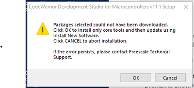

I am trying to install CodeWarrior for MCUs (v11.1) using silent install.  I read on another forum that this can be done using /S switch, which does work.  the command i use is shown below.
Setup.exe /S /D=C:\NXP\CW_for_MCUs
But just after i run this command i get the following prompt that i must press "OK" for to get the install to proceed.  Once I press "OK" the install proceeds successfully.
I wanted to know if there is a way that this prompt can be suppressed so the install runs without any user interaction.  I need this to be able to install CodeWarrior onto a docker where I will only have access to the command line (no GUI).

Unfortunately, silent install is not supported since CW10.6 so it's not supported in CW11.
Felipe
