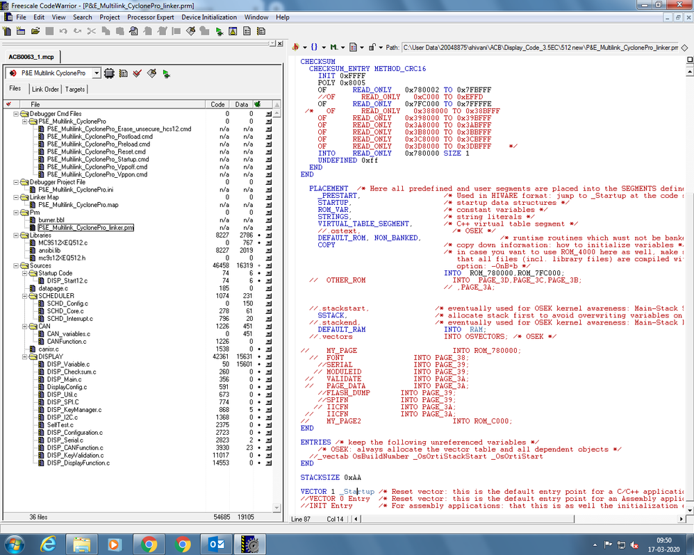

Hi i am using code warrior. Earlier i was using MC9S12C128 microcontroller and due to the lack of memory we planned on using MC9S12XEQ512 controller ic. i replaced everything related to the new controller and made all possible chnages. the only error i am getting now is Linker Messages: L1108: Initializing of Vector <Name> failed because of <Reason>.
so for this what am i suppose to do?

can you help me out with what all changes i have to do in the code. i am attaching the screenshot where the startup if defined.Untitled.png

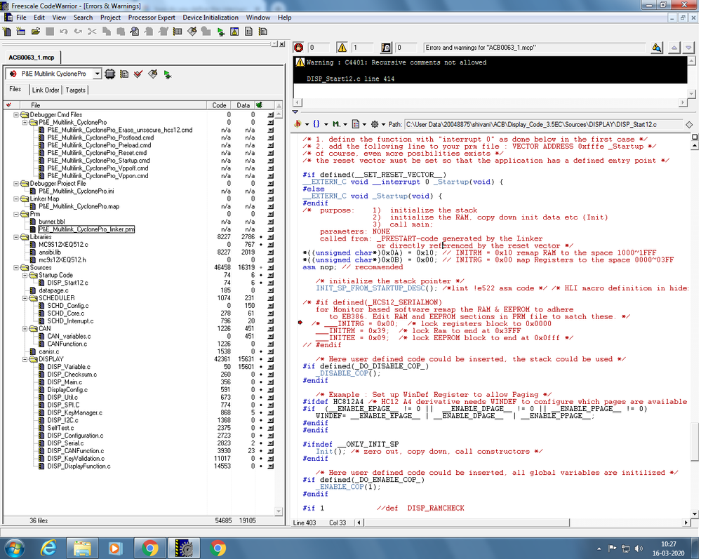

from your screenshot. there is warning C4401. Is this related with the original que?
Please send me your demo project and tell me which error message you want to fix?

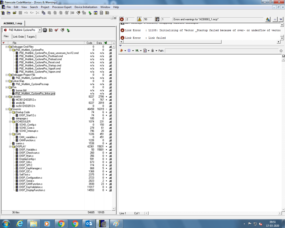

Please set startup to vector 0:
VECTOR 0 _Startup
If this can't help you fix the problem, send me your demo project rather than screenshots. I need to reproduce first.

I have attached the prm file which is containing error. So basically due to the memory issue we changed the controller from 128 to 512 so we did possible changes for that in our code now in this file its showing this vector startup failed error. So please go through my code an tell me what should I change.

I suspect the problem is caused by the fact you placed Startup and even NON_BANKED sections into banked memory.
Interrupt vector table is composed from near pointers entries (2 bytes)  so typically routines must be placed into non-banked memory.
so I'd suggest to enter change the placement for these sections in prm.
