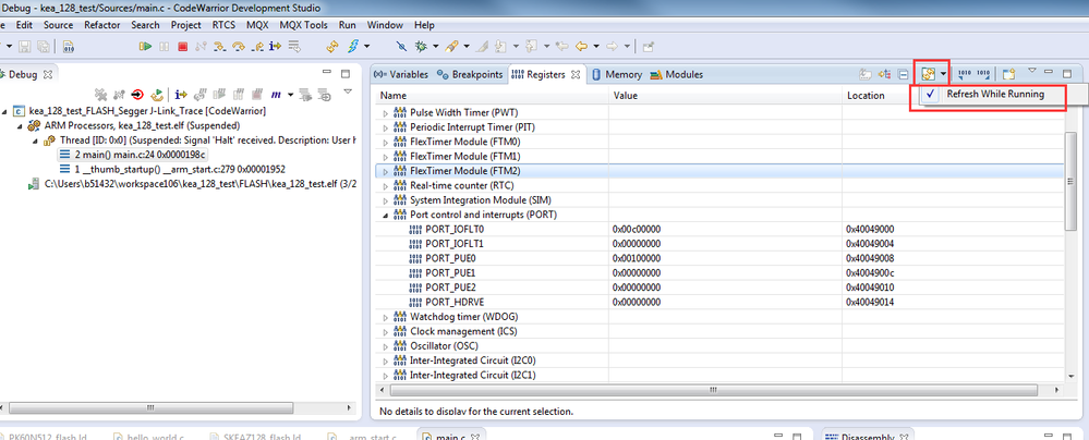

Is it possible to monitor the status of I/O pins in CodeWarrior during a debug session using Multilink? I would like to see the configuration and pin output value (logical, of course) as I single-step through the code. I can measure the actual voltage, but this does not match the value written to the pin register.

Thanks, it answers my question. I am migrating from KEIL IDE (LPC9XX) and they display a peripheral as a graphic in which I can set/clear any bit in any register by clicking on the appropriate box. I guess I was looking for something similar.

Hello Julian,
Yes, you can check the related register on Register view on CW:
Please enable the "Refresh While Running" , then register can  update in running time .
Hope it helps
Alice Yang
