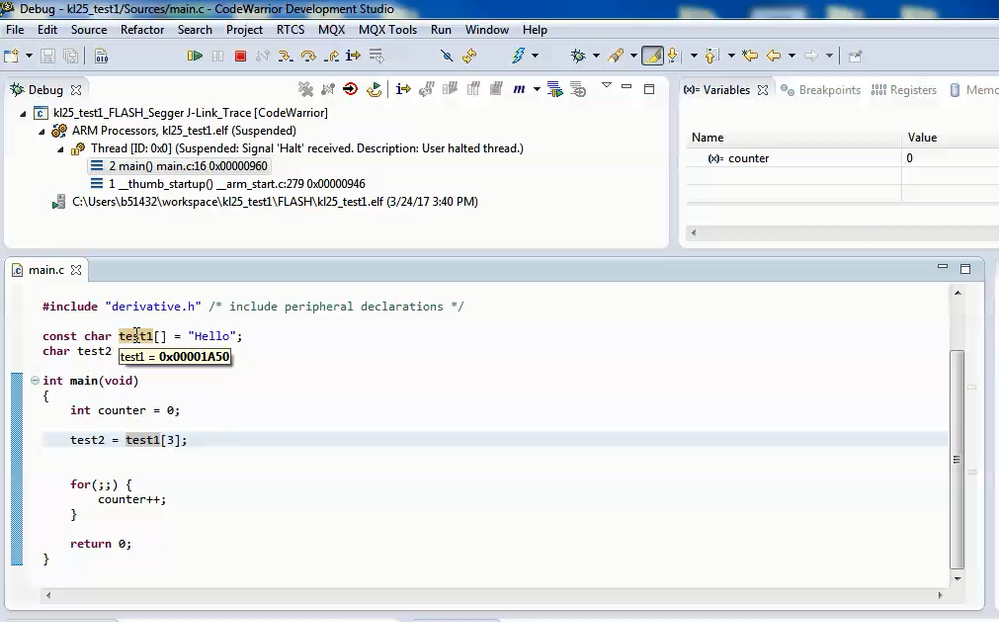

Hello Yadu,
On CW v10.7, the const data is stored in flash :

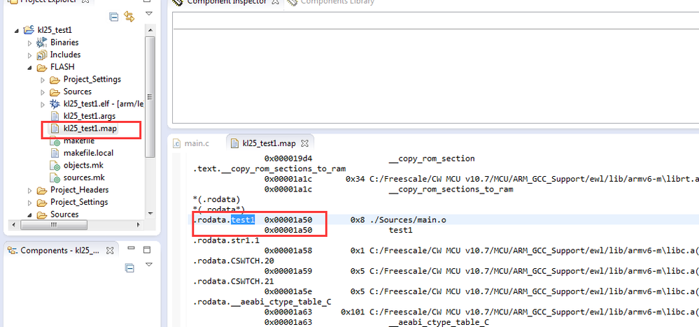

You also can checked it on the .map file :
If your project is not , you can send your project to me.

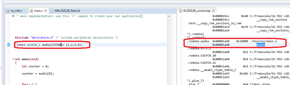

   I have another problem in storing the value. I am storing a audio hex file as const uint16_t. But I couldn't store more than 5kb, it overflows when I did that or got to PE_DEBUGHAULT function. I am using frdm-kl25z, it has 128kb flash then why can't I store atleast 64kb value in it. please help...
4,076 Views
stanish
I've just tried to build the project with such a constant and at works fine on my side. Constant is allocated in FLASH and there is no overlap:
Stan
4,076 Views
Hello ,
In your project not only the hex file saved in flash, you can check the .map file about
the actual memory used . Or you can also send your project to me , I help you check it.

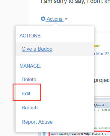

I am sorry to say, I don't know how to attach my project. Could you please tell me how to? :smileyhappy:
4,076 Views

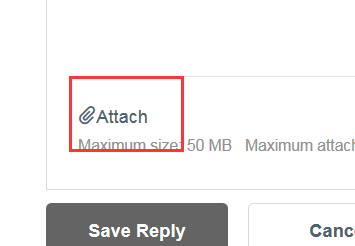

Hello ,
- About how to attach project :
Alice
