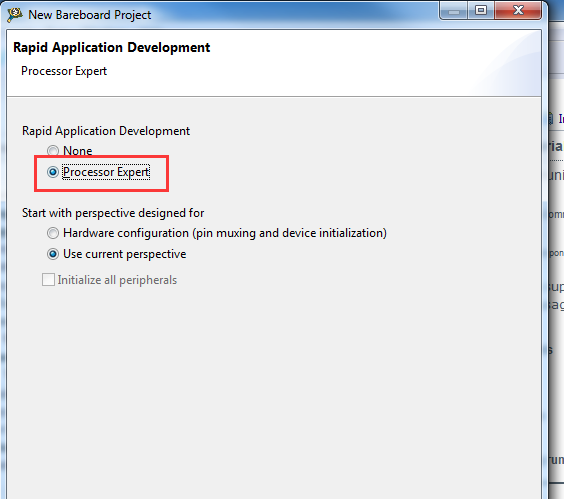

Hello minh,
You can use the lasted version of CWv10.7:
CodeWarrior for Microcontrollers-Eclipse IDE|NXP
it supports this chip.
In CW , create one project with Processor Expert , there will be demo :
when create project select "Processor Expert":

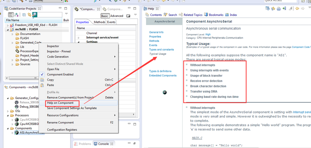

For example the AsynchroSerial  demo :
Hope it helps
