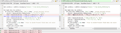

We've analyzed the reports and found that there is an issue with handling on of the PIDs in your system. We will work on a fix in our next release,  but in the meantime please try this workaround:
For version LinkServer_24.9.75, modify the “c:\\nxp\\LinkServer_24.9.75\\binaries\\Scripts\\listusb.vbs” script:
  • change line: sPID = ReplaceX(sDvcID, ".*PID_([^\\\&\+]*).*", "$1")
  • with:             sPID = ReplaceX(sDvcID, ".*PID_([^_\\\&\+]*).*", "$1")
Let us know if this works for you.

Thank you. That workaround works for me.
