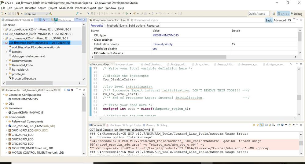

I use the following:
CW for MCU V10.7
Freescale Assembler for Embedded ARM family.
Version 2.0 build 59 (build 59)
Freescale C/C++ for Embedded ARM.
Version 5.1 build 59 (build 59)
Freescale Linker for Embedded ARM.
Version 3.0 build 59 (build 59)

Your screenshots indicate you are using the depreciated/legacy Metrowerks ARM compiler. That option only exists for the GNU gcc compiler:

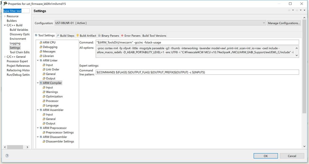

I tried to build a program with "-fstack-usage" compiler option.
However, an "Unknown option" error has occurred.
Did I make the wrong setting?

Do you know if this ARM compiler does not have a stack usage analysis option?

It does not have such an option.
