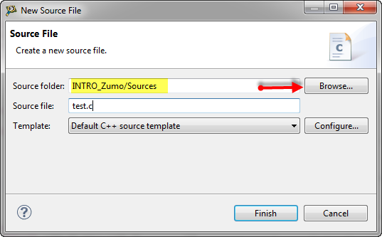

When I create a new source file in a project, it will create a xxx.c under the current folder.
How could I set the CW10.4 so that when I create the source file, it will create it in specific folder?
Thanks.
1 返信
1,068件の閲覧回数
BlackNight
It will use the folder you right click on as the default.
If you want to use a specific folder, either type the path or use the browse folder:
