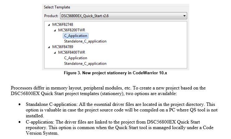

In document "README.txt file for DSC56800EX_Quick_Start" is note about installing "Freescale Stationery New Project Wizard". Where can I find it?

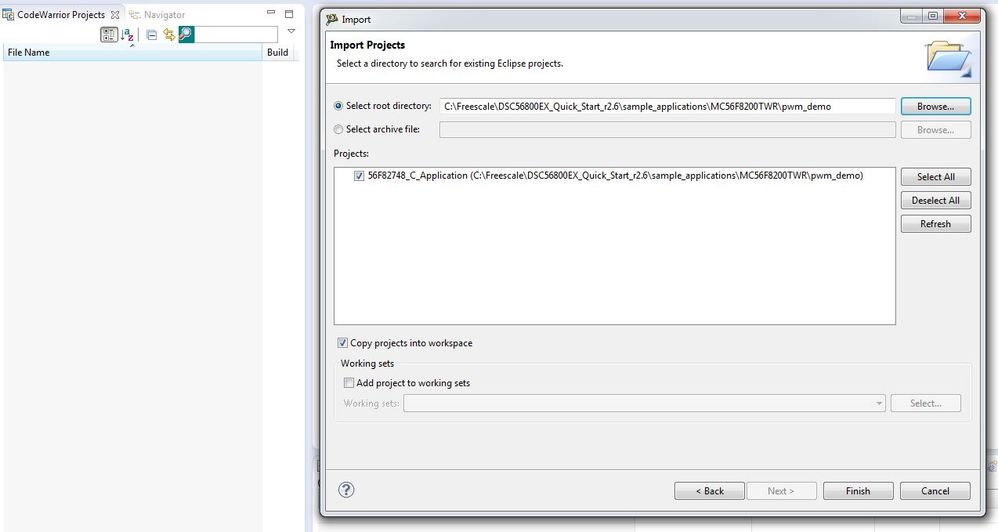

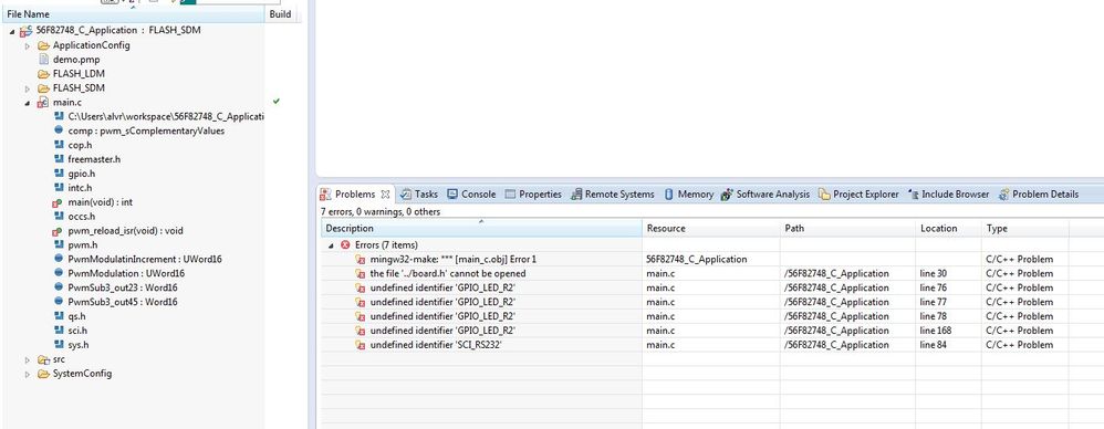

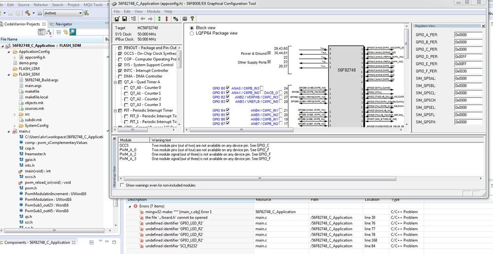

I have already integrated QuickStart to CW and imported first sample project from QuickStart folder (pwm_demo). When I was imported it to CW, so I can even launch GCT from hot key now. I thing that this integration works. But when I have builded this sample project many errors appears. I dont know what can be wrong because I have no experience with it for now. Can someone help me how can I easilly start or recomend me some working sample for my start? Or next question. Can I make new QuickStart project even direct from CW-file-new-....? I cant find any QuickStart project choice from this menu. Shoul I only use import sample project every time?

The new stationery project wizard is in new->project menu.
Select Freescale->New Project Wizard

Thanks for the reply, this QS r2.6 plugin works for DSCs 82748 and 84789, but currently i work with older 56f8257 and its not in the project wizard. Do you have similar plugin with new project wizard for 8257 with quickstart support?

For older devices you can try using QS r2.5. Once you install it you can again browse through the demos from your start panel.

I still cant find how can I make new clear QuickStart project in CW? I have found steps in documentation (for example screen 9.jpg from AN4816), but I cant find this possibility in my instaled CW ??? :-( 9.JPG.jpgPlease, help.
