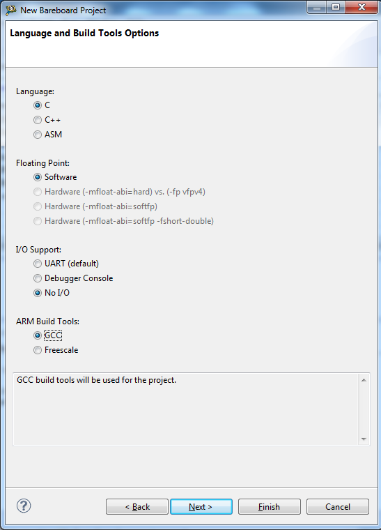

We are using Codewarrior 10.6. The processor is MK20DX128VLH7, 64 pin package. Using Processor expert, C code, No I/O, ARM Toolchain when creating the project.
Creating a new project only provides for the 100 pin variant to choose from. I added the 64 pin part from the processor expert, this is when I get the message "Incorrect toolchain selected in the project settings. Please change your project setting to use 'ARM Toolchain' or change the selected Compiler".
How do I get the 64pin package to use the same Toolchain?

I tired on CW10.6, but did not reproduce the problem. Did you select the same options with me?
I attached the project which I have changed the CPU into 64-pin MK20DX128VLH7. It built well.
