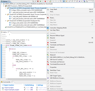

When I'm debugging, I have many threads, how do I know how long a particular thread is taking? Are there any special views or options?- CodeWarrior for MCU Version: 10.4

I suggest you check trace feature. Please read Profiling and Analysis Users Guide.pdf under CW install folder.
