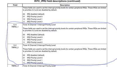

xiangjun_rong
Pls download the DSP56800EX core reference manual DSP56800ERM.pdf from the link:
https://www.nxp.com/products/processors-and-microcontrollers/additional-mpu-mcus-architectures/digit...
Pls refer to section 9.3.1 Interrupt Priority Structure as following.
If you set the priority of timer, for example set  TMRA_1 as 1, TMRA_1 as 2, you can not implement the nested interrupt, because when TA1 ISR is being executed, the CCPL bits will add 1 automatically, which forbids that the same priority ISR preempts it.
You can set the TMRA_1 as 1, TMRA_1 as 3 to implement the nested interrupt.
Regarding the phenomenon that "Without this protection, Timer A1 ISR stops being called.", I suppose that TA2 period is 50uS, the period is too small, the TA2 will occupy all the source so that the TA1 has not opportunity to be executed.
Pls try to set the period of TA2 as 50mS, TA1 500mS and have a try.
