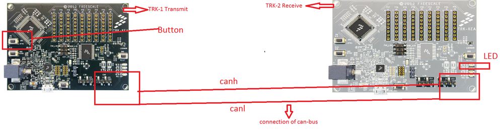

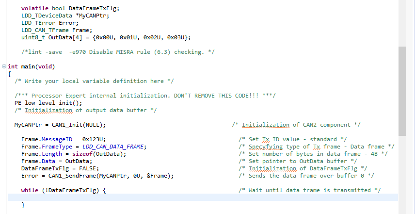

Hi Friends, I have two piece Trk-kea128 boards. I am using Code Warrior and Processor Expert .
I want to Can-Bus communication between two boards.
When I pressed button TRK-1 will send message and When TRK-2 received true message The led will turn on.
Uğur

ugurozkan52

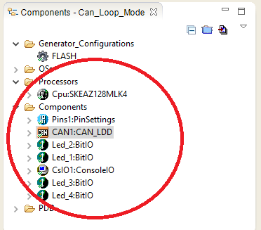

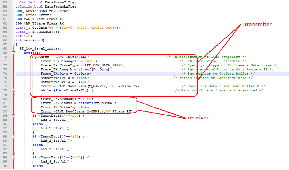

Hi Alice,
I didn't add Gpio_LDD because I am writing code of loopback but It isn't working.
Can_Tx <======> Can_Rx short circuit
I am using Can_LDD and Bit_IO and Console_IO.
My code is here.
I am sorry for I couldn't answer early.
Uğur

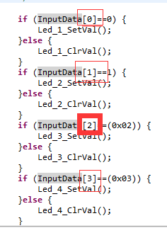

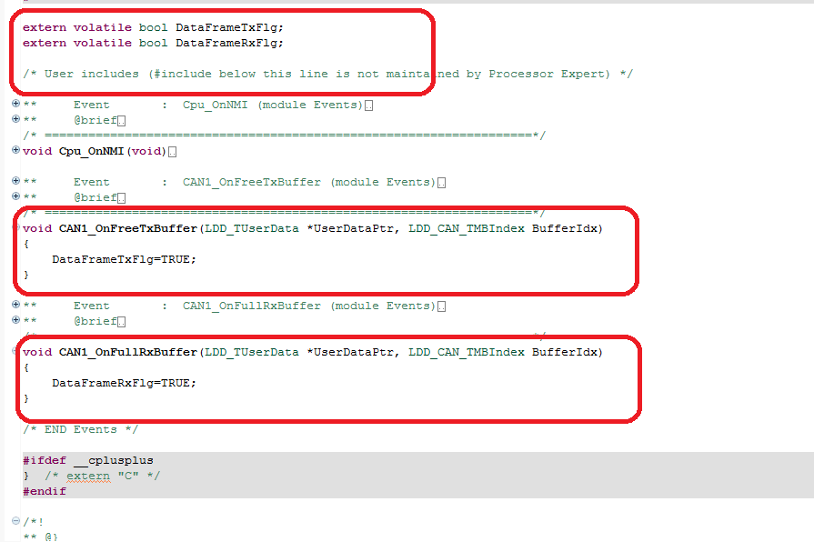

Hello Ugur,
I have checked your project and test on my side .
Please change these place :
1) Please enable the CAN interrupt, or you can not use the interrupt function , so the flag of
"DataFrameTxFlg" can not set to "TRUE" :
2) The array of " InputData[]" is start from "0", not "1" , so please configure the code to "
Then re-build the project ,the LED can light , i have test it on my board .
Hope it helps
Alice

ugurozkan52
Hi Alice,
I wrote this code but I couldn't add button code. how can i add button code?
Ugur
9,065件の閲覧回数

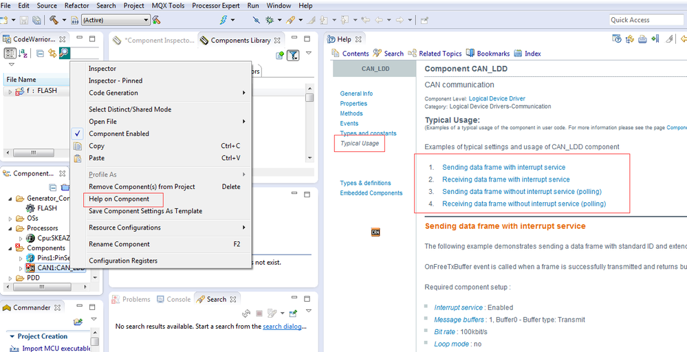

Hello Ugur,
You can  add one "GPIO_LDD" component , then configure the gpio to your button pin.
Hope it helps
Alice

Hello Ugur,
You can configure the GPIO interrupt to send message ;
in the CAN receive interrupt to set on the LED.
About the CAN send and receive configuration, please refer to the
"Typical Usage" :
Hope it helps
Alice
