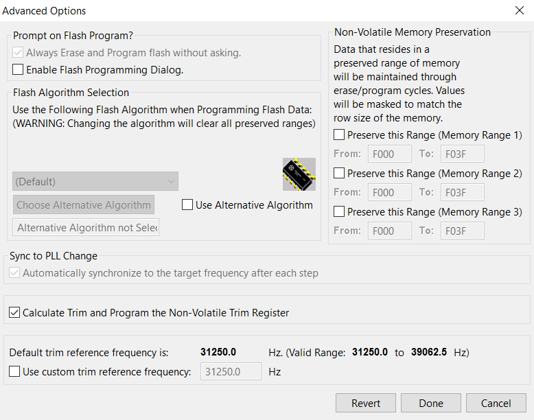

Here is a problem that I’ve been struggling with unsuccessfully (as of yet).
I am using CW Target Tasks in order to burn (program) an image to flash.
My target MCU is MC9S08QG4.
I have configured the task (TTF file) to execute the following operations:
– Unprotect all sectors
– Erase all sectors
– Program image
Flash address range is 0xF000 thru 0xFFFF.
For all it matters (though I don’t think that it has anything to do with the problem at hand), the security bits (SEC01:SEC00) are located at 0xFFBF.
Now, this task occasionally fails.
The output I get in the console varies.
Here are a few examples:
– Error: Erase sector failed. Operation timeout.
– Error: Protect Command Failed. Operation timeout.Failed to erase sector data.
– Error: Detect frequence Loop count suspended
– Error: Can’t resume target HC/RS/S12Z GDI Protocol Adapter : An error occurred while trying to write registers. The Debugger can not write one register.
If it helps, then you can see the entire output (successful and non-successful cases) at:
https://community.freescale.com/thread/391365.
Now, I would normally suspect the HW (power supply, cable length, CPU clock / oscillator, physical connections, etc).
However, when I program the same image via the debugger (i.e., Run Configuration –> Debug), it always completes successfully.
So there is definitely a “soft” way to resolve the problem that I am experiencing, and I am left to conclude that the CW debugger performs additional operations during the image-download procedure (operations which I have skipped in my task).
The question is – what exactly are these operations?
I have searched through my project’s Run/Debug settings, but I have not found anything to explain it. In fact, I feel quite limited in the ability to even compare the two methods, as they seem to be using a different interface and/or language:
– The target task uses TCL (though the TTF file is in XML format, so I don’t quite see how I can add TCL commands to it anyway).
– The CW image-download procedure runs via some other functionality, which I do not fully understand.
One way to see what CW is actually doing “behind the scene”, is by enabling the Flash Programming Dialog option (in the project’s launch-configuration).

One possible cause of your problem is clock trim.
one difference between debugging from Simple Flash/Task   and debugger is that:  TRIM can work for debug while not for Simple Flash/Task.
that's to say, We can only use debugger to perform trim but can’t with CW standalone programmer in the same way. CW is a professional development tool(edit, built, debug), but not professional standalone programmer.  If user need advance feature in standalone programmer, we need other 3rd programmer software.
http://www.pemicro.com/products/product_viewDetails.cfm?product_id=27
Hope this helps!

Just to complete this post - the PROGHCS08 utility (from P&E-Micro) indeed resolves the problem.
Here is a usage example:
C:\PEMicro\PROGHCS08\cproghcs08.exe prog.cfg INTERFACE=USBMULTILINK PORT=USB1 /logfile prog.log
Where file prog.cfg contains the flash-programming sequence.

Funny enough, the two issues that you've mentioned (TRIM value and PE-Micro product) are the exact same conclusions that I've reached during my investigation:
1. I have noticed the TRIM in the Advanced Options configuration window (below), and I suspected that it could be the difference between the debugger operation and a standalone task... But I did not suspect it to the point where I thought I should bring it up to your attention.
2. I have already (yesterday) ordered PE-Micro's Command-Line Flash-Programming utility (well, to be precise, I ordered PROG08SZ by mistake, and then had to change it to PROGHCS08).
However, there is one thing left unclear to me.
By enabling the Flash-Programming Dialog (in the window above), I can clearly see the operations executed by this utility.
