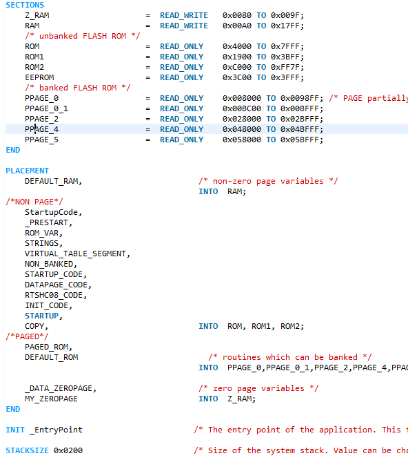

Hi All,
When I upgraded from mc9s08dz60 to mc9s08dz96, I got this error:
Fixup overflow in _vect2, to SysTimer_Interrupt type 1, at offset 0xC
Fixup overflow in _vect2, to RFIRQ_Interrupt type 1, at offset 0x12
Fixup overflow in _vect2, to Cpu_Interrupt type 1, at offset 0xE
Fixup overflow in _vect2, to Cpu_Interrupt type 1, at offset 0xA
My code was working with mc9s12dz60, how can I fix this?
Thanks!
prm file:
Interrupt vector table:

Please check where are the ISRs placed into. I assume they are placed in paged/banked memory - DEFAULT_ROM.
I'd recommend you to add an explicit pragma to place the ISR into non-banked memory segment e.g see the snippet below:
#pragma push
#pragma CODE_SEG __NEAR_SEG NON_BANKED
interrupt void SysTimer_Interrupt(void);
#pragma pop‍‍‍‍
Hope it helps.
S.

Hi Stanislav,
Thanks for your reply, I according to your suggestions tried and solved the problem.
But I don't understand why can't the ISRs are placed in paged/banked memory, My interrupt vector table are placed in a fixed cpu address @0xFFC0.
Best Regards!
Jiaxing Deng
5,052 Views
stanish
This is because of how interrupt vector table is implemented on HCS08/HCs12 architectures.
There are just 16 bits (near) pointer dedicated to each interrupt vector - this is hardwired.
It makes sense since for a long time HC08 cores didn't have more than 64kB of flash memory. To keep backward compatibility it is the same on devices with more 64kB of Flash.
Now on such a devices you need to take special care about where ISR routines are placed so they can be accessed by near 16bit pointer.
Hope it helps.
Stan
