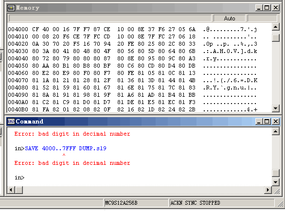

How to use HIWAVE to save all the memory(programs) in MC9S12A256CPVE FLASH to my computer?thank you very much
2,247 Views
1326532996
2.pngHow to save all FLASH
 program to my computer become a file xx.s19 or xx.abs   thank you,I need all memory
in>SAVE 4000..7FFF DUMP.s19
Error: bad digit in decimal numbe

You have to use 0x as prefix for hexadecimal numbers:
SAVE 0x4000..0x7FFF DUMP.s19
I hope this helps,
Erich

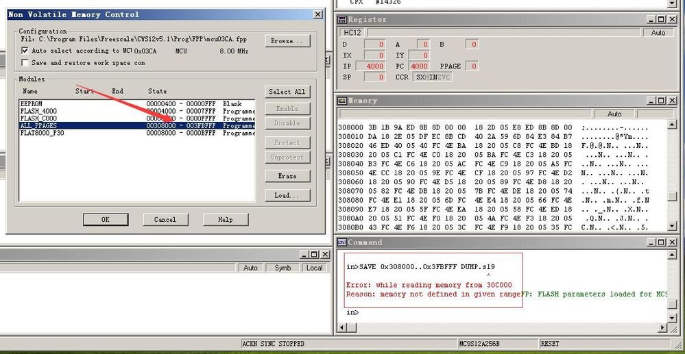

1326532996
Hi  Erich
Thank you for answering my question!I have solved the problem
But there was an error when save the third paragraph4.jpgError: while reading memory from 30C000
Reason: memory not defined in given range
How to solve?
