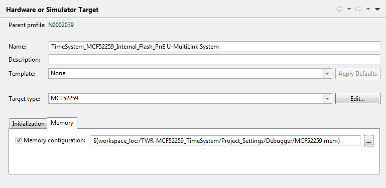

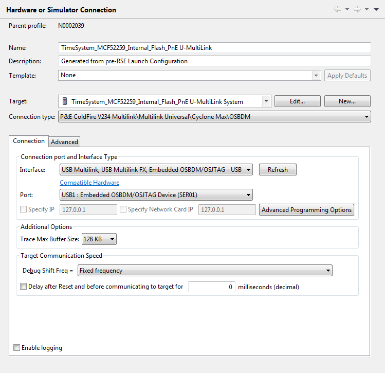

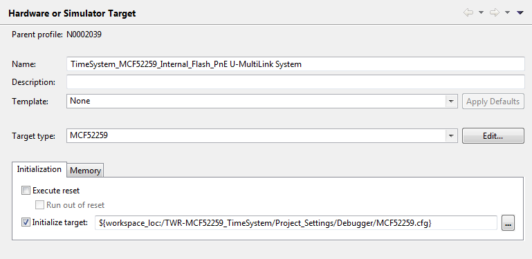

Below are screenshots of my settings. Can you verify them?
Erich

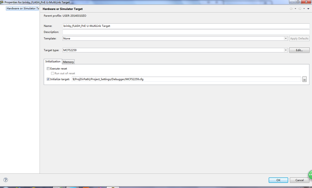

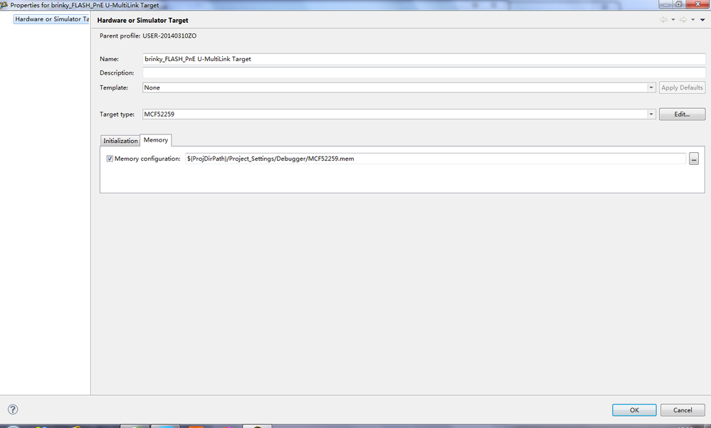

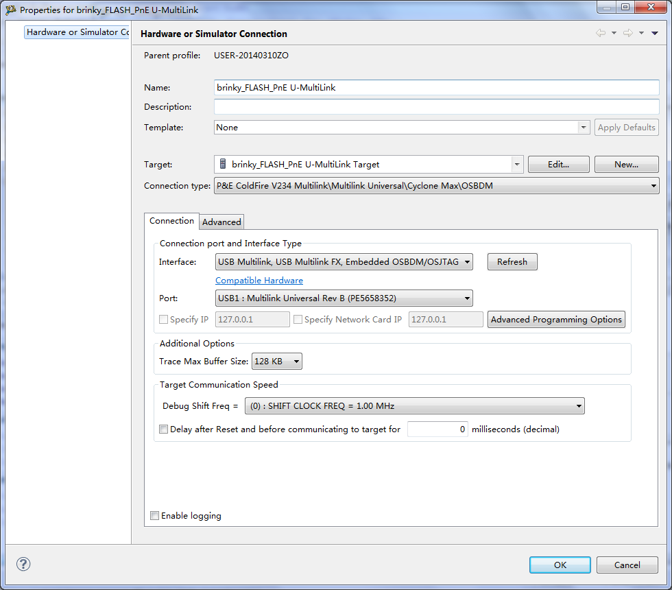

guilongxiao
4,290件の閲覧回数
guilongxiao
I check my settings as above.Do you have any advices?
