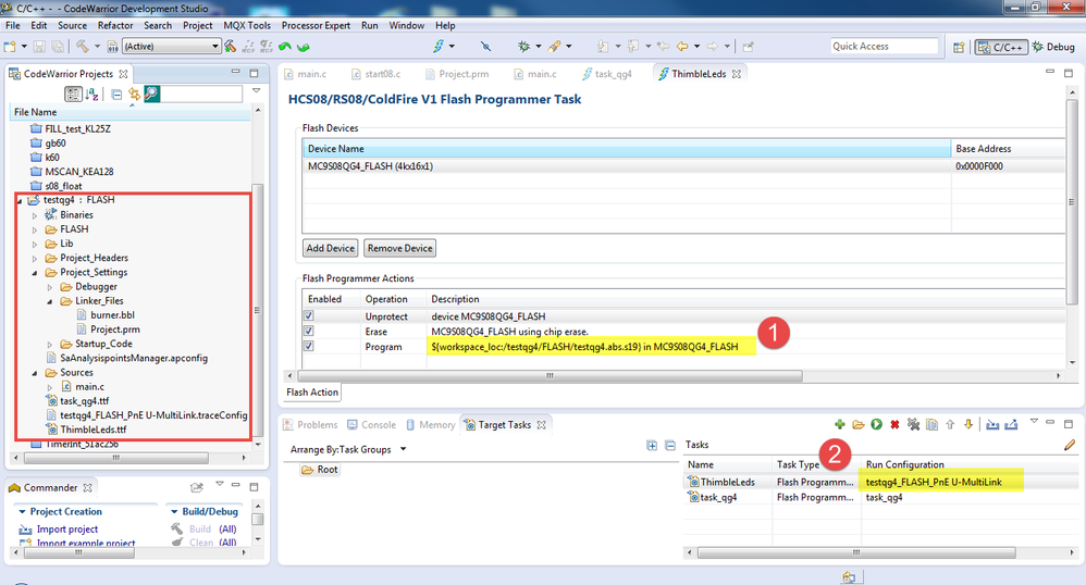

While attempting to program MC9S08GQ4 flash through CW task (TCL), we are getting the following error:
fl::target -lc "MyTask"
fl::target -b 0x60 0x100
fl::target -v off -l off
cmdwin::fl::device -d "MC9S08QG4_FLASH" -o "4kx16x1" -a 0xf000 0xffff
cmdwin::fl::protect all off
Beginning Operation ...
Performing target initialization ...
Device MC9S08QG4_FLASH
Detect frequence ...
Frequence 4506.96 Khz
Flash Operation.
Error:  Erase sector failed.  Operation timeout.
UnProtecting .............
Error:  Protect Command Failed.  Operation timeout.Failed to erase sector data.
When downloading (programming) it through the debugger, everything runs smoothly.
The task itself performs:
- Unprotect all sectors
- Erase all sectors
- Program image
As you can see, the 'unprotect' part fails on attempting to erase a sector (what is that supposed to mean anyway???).
The only reference I've found to this problem, is that the debugger trims the oscillator (not even sure what this means).
Any idea what could cause this problem?

9,744 Views
ZhangJennie
I just tested your ThimbleLeds.ttf from my side. It runs normally on my side.
in order to make it work, I create a dummy QG4 project, that generates a run configuration file and a s19 file for testing.
what I modified on your ThimbleLeds.ttf are:
1. becuase I don't have your s19 file, I use the s19 file generated by testqg4 project
2. set run configuration file generated from testqg4 project
then click on run, it executes successfully.
I attached my testing video.
I downloaded the video I uploaded previously from another computer, it can be played with windows Media player. please try another video player for it.
Jennie Zhang

barakmanos
Hi Jennie.
Thank you for your quick response.
I am unable to watch the movie (I'm pretty sure it's corrupted or something).
But I do know what "Flash File to Target" is, and no - I am not using this option.
I am using a predefined task, see enclosed ttf file and screenshot (see enclosed files).
In opposed to downloading (programming) through the debugger, which always runs smoothly, this task doesn't always complete successfully, as depicted in the original post (above).
When this task does complete successfully, the output in CW console is:
fl::target -lc "ThimbleLeds"
Frequence 4282.39 Khz
Flash Operation.
Unprotect Command Succeeded.
cmdwin::fl::erase all
Erasing .............
Erase Command Succeeded.
cmdwin::fl::image -f "E:\\Production\\ThimbleLeds\\Bin\\ThimbleLeds.s19" -t "Auto Detect" -re off -oe off
cmdwin::fl::write
Flash Operation.  ...
Auto-detection is successful.
  File is of type Motorola S-Record Format.
Programming .........................
Program Command Succeeded
Flash Operation. done
But again, this doesn't always complete successfully, so I've figured I must be missing something which the CW debugger takes care of.
Thanks again for your kind help :smileyhappy:

ZhangJennie
do you use "Flash File to Target" to program the flash?
I don't have QG4 but I just tested it with QG8 it works fine from my side. see attached video.
can you please let me know how to reproduce your problem?
Jennie Zhang
