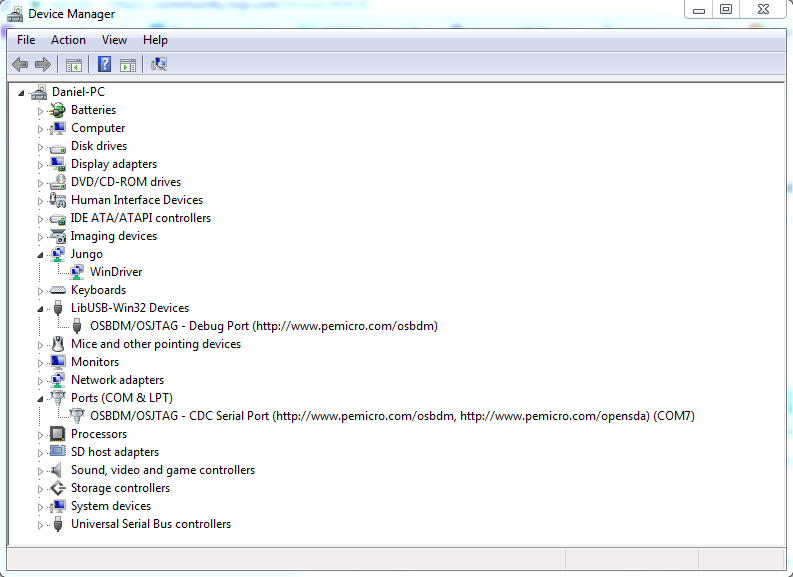

I have installed the P&E Drivers v12.4.0.0 and connected the DEVKIT-S12G128 to the PC using the supplied USB cable. The demonstration code (flashing LED) starts running on the DEVKIT-S12G128. Below is a screenshot of Device Manager:

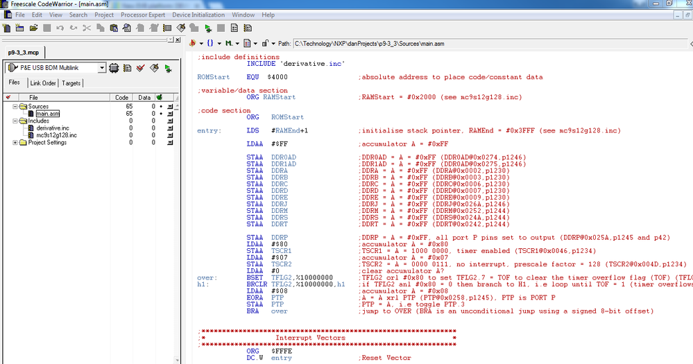

 I wrote and built without errors a short assembly program to flash the LED. I selected "P&E USB BDM Multilink" as per the instructions in the "SOFTWARE INTEGRATION GUIDE (SWIG)":

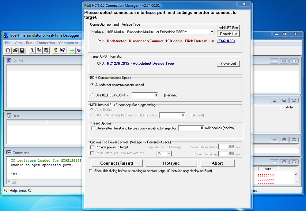

When I press the "Debug" icon the "True-Time Simulator & Real-Time Debugger" screen says "Unable to open specified port" and the "P&E HC(S)12 Connection Manager v2.74.00.01" screen says "Undetected. Disconnect/Connect USB cable. Click Refresh List". This does not work. It also has a link to "FAQ #29", which advises to uninstall and install the P&E Drivers, which I did. This did not work either.

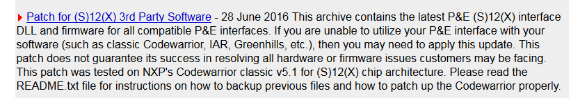

Hello Dan,
When use the classic CodeWarrior with P&E debug , there is a patch you need install,
about the detail information please refer to here :
P&E Microcomputer Systems: Over 30 years as an Industry leader in Embedded Systems Development Tools...
Hope it helps
