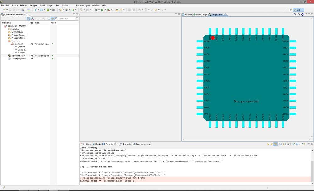

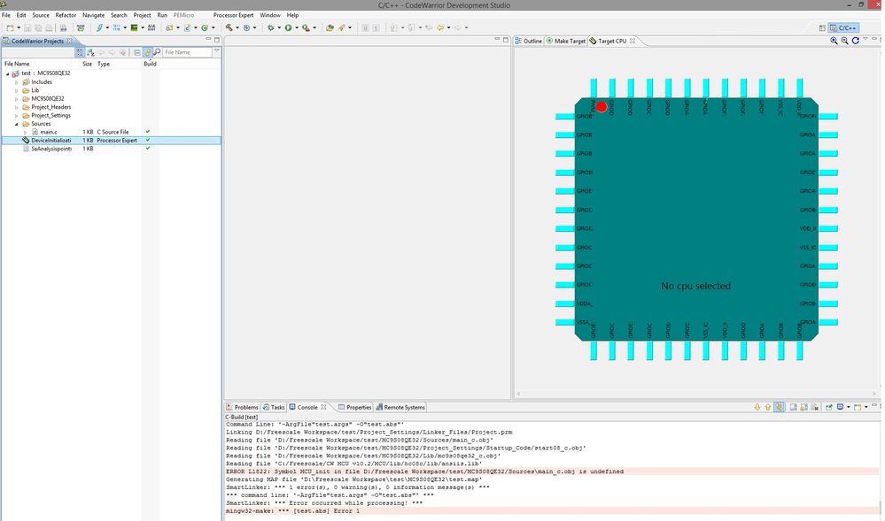

Hi, I am using CW 10.2 installed on my Win 8 machine. I could't launch device initialization for both assembler and C project.
Te target CPU tab shows No CPU Selected with no option for me to select MCU.
I am using 10.2 because this is the last version which still supports device initialization for assembler.
Can anyone help?
Thanks.

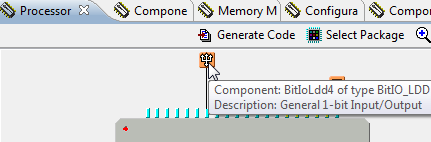

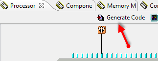

I do have the 'Generate Code' in the Processor view:
This is new in 10.4. So you do not have this?
If I click on a component in the Processor view, then it opens for me the inspector too:
And yes, if you use the project menu, it needs a project selected in the 'Components' view or in the 'CodeWarrior Projects view'.
Same for clicking on a component in the components view: this opens the inspector for me too.
I'm wondering why this is not the case for you?
