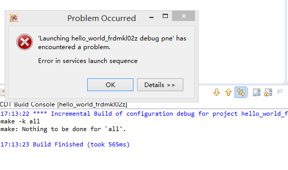

I am trying to debug a KSDK example application on  FRDM-KL02Z, but after building the project,the problem occured,just like this window:
please someone  help me to figure this problem,Im a new man.

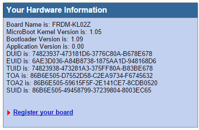

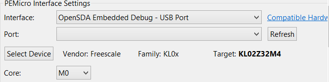

Tried reinstalling PE driver, can see it in Device Manager, cannot see it in the Debug Configuration (see pictures). Tried to run dummy sample that was suggested above.. No results, same error.
Debug Configurations:dadsa.PNG.

if there is nothing listed in the 'Port' settings, that means no debug drivers are found or present.
About drivers: see here: Fixing the USB Drivers | MCU on Eclipse
From your PE hardware information, it seem that you have not loaded the debug OpenSDA firmware on the board?
Are you sure you have loaded the correct debug firmware? Note that if you have received a board from the factory, then you need a Windows 7 machine to update the bootloader and to load the debug firmware (you cannot do this with a Windows 8 machine).
See here for instructions (again, you need a Windows 7 machine):
Illustrated Step-by-Step Instructions: Updating the Freescale Freedom Board Firmware | MCU on Eclips...

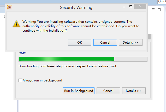

I remember that I met another situation when I was installing KSDK 1.3.0 Eclipse Update.
I choosed OK button and continue to install it. Then debugging attempt failed, it may caused by this warning (I guess!)

then another problem occurred at 95% launching the debug session,here is screenchop:
sorry to trouble you again,
I just dont know how to deal with it.
