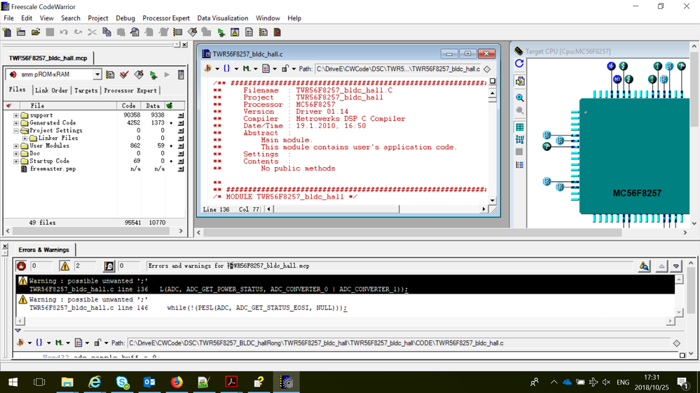

Hi, Ben,
I just compiled the project TWR56F8257_bldc_hall project with CodeWarrior for DSP56800E ver8.3, no problem.
I attach the screenshot here.
I also attach the project in the forum, pls download it.
Hope it can help you
XiangJun Rong

Ben
Senior Contributor I
Thanks Rong,
I believe that it passed good as you are using CW8. I did not use this old version for several years.
Actually, I imported the project to CW11, and maybe it caused all the errors.

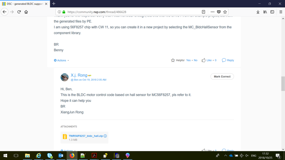

xiangjun_rong
Hi, Ben,
This is the BLDC motor control code based on hall sensor for MC56F8257, pls refer to it.
XiangJun Rong

Ben
If you are talking about the TWR56F8257_bldc_hall.zip file, I gave-up using it as it caused too many errors.
Most of them are errors with nexplanation and I did not succeed to handle them, so I re-started from a new bareboard project.
