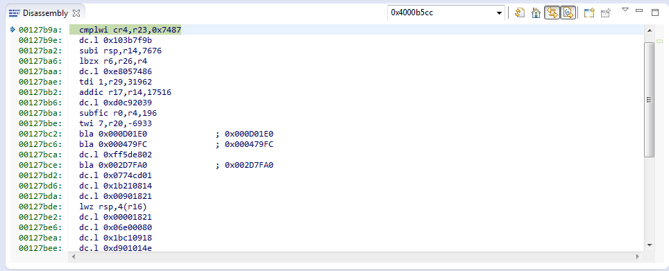

The disassembly window in the debugger is interpreting the assembly as non-vle instructions when they are actually VLE instructions. I can't find a setting to force this window to interpret as VLE. The project settings are all for compiling VLE.
Target is an MPC5634M.

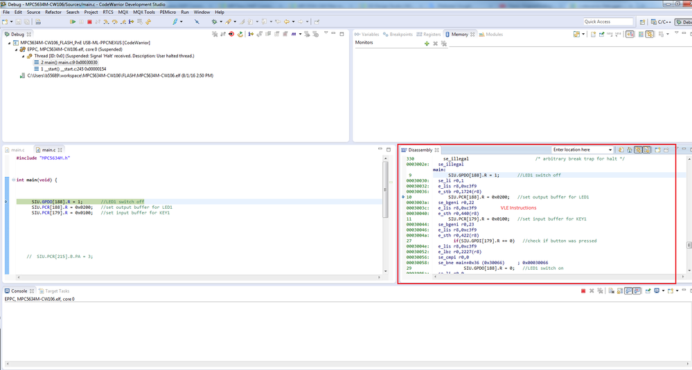

I am not sure, if Joseph fix his problem, but I found the root cause of this issue. MMU entries affect if you see bookE or VLE instructions in the disassemble window. There is VLE bit, which could be set to 0 or 1.
Please look at the document in the attachment, which shows, how this VLE bit affect disassembly window.
So look and let me know, if it works on your side.

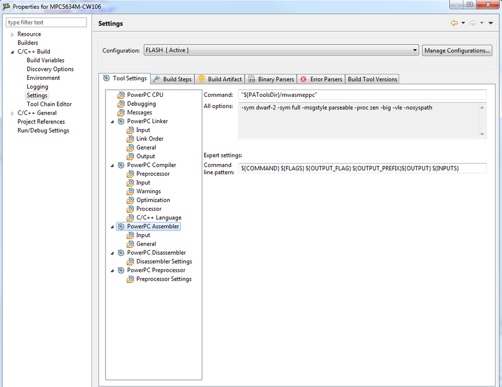

I have just tested the case you describe. I have created default project for MPC5634M and I chose VLE instruction set in startup wizard. As a debug probe I have used PE Micro USB Multilink.
This is what I see in debugger disassembly window:
Are you sure you chose VLE instruction set instead of BookE?
Please check the following setting in your project:
Martin
13,090 Views
josephperrin
My settings match yours.

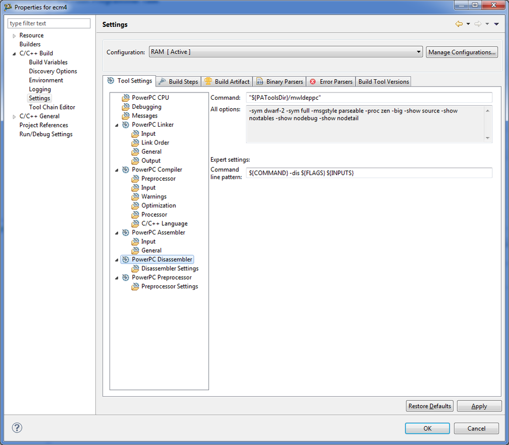

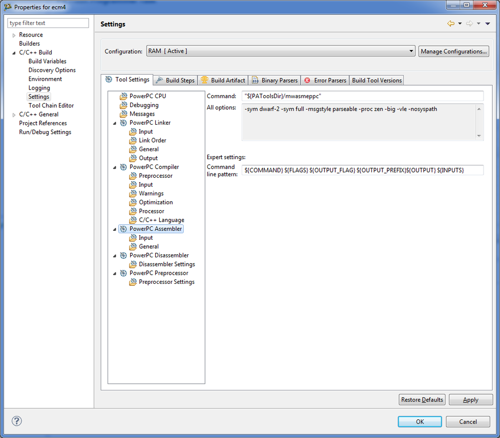

could you please send me the screen of your disassembly window and also screens of PowerPC compiler settings (I need to see all compiler flags)?
Martin
13,090 Views
josephperrin
Joe
13,090 Views
martin_kovar
Hi Joe,
from the screens you posted I am not able to tell you, what is wrong. Is it possible for you to share the project (or some simplified), which shows the issue?
