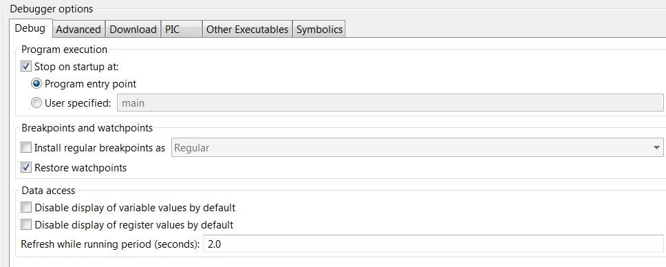

I am having problems getting breakpoints to be hit in my application as well as codewarrior processor expert example applications. I tried the example projects when I found I could not get the breakpoints in main to be hit - I thought it may be an issue with my own application but the example projects also have the same problem. I can step through fine inside _EntryPoint() as seen below. For the debugger options I have set the Program execution to Stop at Startup on the Program entry point. I also tried user specified (main) but both yield the same result. I cannot get the breakpoints in the main function to be hit. The program executes successfully.
The debugging starts at:

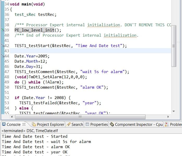

Here it is fine I can step through, however after it goes to the asm(JMP init_56800_) then it starts to step into the 56F83x_init.asm. I have put in breakpoints in the main function as seen below but none of these breakpoints are hit even though the program executes successfully. Is there some setting I am missing?

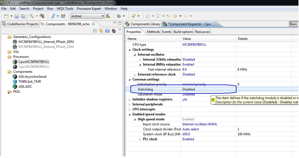

Please check whether you have disabled watchdog:
By default, the watchdog is enabled after target reset.

Hello - yes the Watchdog is set to disabled.
