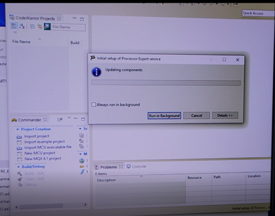

The installation of CodeWarrior v11 on a Win10 PC worked fine.  However, upon launching the application a crash results 3-4 seconds after launch.  I tried both the offline and network install.  The following dialog appears very briefly (< 1 sec; had to capture on video) just as the application shuts down abruptly:
The workspace log reports:
!ENTRY com.freescale.processorexpert.core 1 0 2022-06-27 11:34:43.409
!MESSAGE Plugin com.freescale.processorexpert.core.service ProcessorExpertServiceProvider
!SESSION 2022-06-27 11:45:10.624 -----------------------------------------------
eclipse.buildId=I20070613-1755
java.version=1.6.0_15
java.vendor=Sun Microsystems Inc.
BootLoader constants: OS=win32, ARCH=x86, WS=win32, NL=en
Framework arguments: -Xss8M -Xms16M
Command-line arguments: -os win32 -ws win32 -arch x86 -Xss8M -Xms16M -clean
!ENTRY org.eclipse.core.resources 2 10035 2022-06-27 11:45:19.235
!MESSAGE The workspace exited with unsaved changes in the previous session; refreshing workspace to recover changes.
!ENTRY org.eclipse.osgi 2 1 2022-06-27 11:45:19.581
!MESSAGE NLS missing message: ContentTypes_errorDialogAlreadyExists in: org.eclipse.ui.internal.messages
!ENTRY com.freescale.core.ide.wizard.ui 2 0 2022-06-27 11:45:23.100
!MESSAGE External elements location 'D:\Freescale\CW MCU v11.1\eclipse\../MCU/lib/wizard_data/mqx/4.0/arm' does not exist
!ENTRY com.freescale.core.ide.wizard.ui 2 0 2022-06-27 11:45:23.106
!MESSAGE External elements location 'D:\Freescale\CW MCU v11.1\eclipse\../MCU/lib/wizard_data/mqx/4.0/ppc' does not exist
!ENTRY com.freescale.core.ide.wizard.ui 2 0 2022-06-27 11:45:23.109
!MESSAGE External elements location 'D:\Freescale\CW MCU v11.1\eclipse\../MCU/lib/wizard_data/mqx/4.0/patches' does not exist
!ENTRY com.freescale.core.ide.wizard.ui 2 0 2022-06-27 11:45:23.289
!MESSAGE External elements location 'D:\Freescale\CW MCU v11.1\eclipse\../MCU/lib/wizard_data/mqx/4.1/arm' does not exist
!ENTRY com.freescale.core.ide.wizard.ui 2 0 2022-06-27 11:45:23.292
!MESSAGE External elements location 'D:\Freescale\CW MCU v11.1\eclipse\../MCU/lib/wizard_data/mqx/4.1/ppc' does not exist
!ENTRY com.freescale.core.ide.wizard.ui 2 0 2022-06-27 11:45:23.295
!MESSAGE External elements location 'D:\Freescale\CW MCU v11.1\eclipse\../MCU/lib/wizard_data/mqx/4.1/patches' does not exist
!ENTRY com.freescale.processorexpert.core 1 0 2022-06-27 11:45:23.726
The log shows the additional arguments I added to the command line to try and resolve this (-Xss8M -Xms16M -clean) but the behavior is the same with and without.
The installer does not have a customize option that would allow Processor Expert component (plugin) to not be installed.

From your photo, There is no any project in CW IDE but IDE produce error message as screenshot. Correct?
To identify if the problem is caused by workspace setting and old associations, please create a NEW workspace folder and open IDE in this  workspace. See if the problem still exists?

That is correct, there are no projects in the workspace.  In addition I used a brand new workspace folder on boot.  Any additional ideas?

You create a brand new workspace folder, Did you create a new project under it to test? We need to know the problem is on a specific project or a common issue for all project.
To test if your CW conflicts with some system files. Please install your CW on anther PC to try the same.
