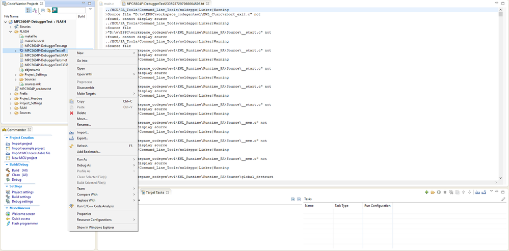

   I am using CodeWarrior for MCU v11.0(Eclipse IDE) to debug the MPC56xx series MCU. I want to know how to generate a disassemble file for the whole project. I try to use the "objdump" command, but the IDE cannnot find it.

right click on the elf file and select disassemble option. Please check the figure below:
This will create disassemble of the project.
