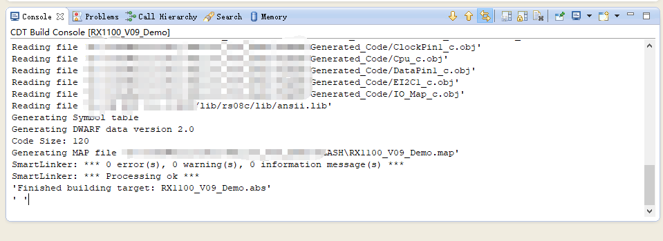

I'd like to make a two branch project. So I try to use preprocessor macros.
Pictures below are an example:
----------- Before I set.
------ Define a 'USE_WATCHDOG'

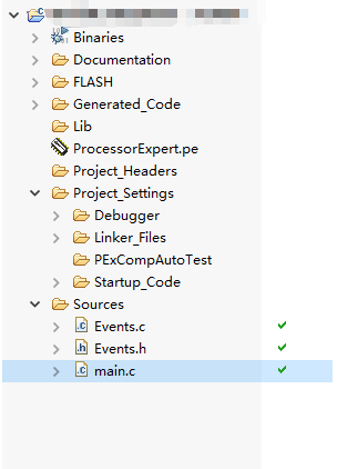

----------- main.c show a key icon on it.
---------- Then my project just generate abs binary file.The S19 missing.

I really think it is the same problem as described in Traps and Pitfalls: No Hex/Bin/S19 File Created with GNU? | MCU on Eclipse : the issues is caused by a 'option per file' usage, as indicated by the 'pin' on your main.c.
And this is an Eclipse problem, not a toolchain problem.

Seems close but not quite the same.
I can debug with the *.abs file.
I'm using S08 mcu, so the tool chain isn't the same.
Makefile has the same problem.
# Add inputs and outputs from these tool invocations to the build variables
EXECUTABLES += \
EXECUTABLES_QUOTED += \
EXECUTABLES_OS_FORMAT += \
BURNER_OUTPUT_OUTPUTS += \
BURNER_OUTPUT_OUTPUTS_QUOTED += \
BURNER_OUTPUT_OUTPUTS_OS_FORMAT += \
