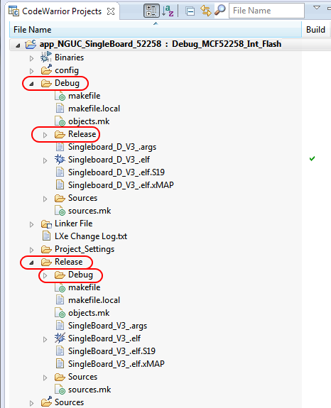

Until recently my project used only the Debug target. I decided to get the Release target working as well. Before my project contained a Debug folder and a Release folder, but now my Debug folder also contains a Release folder, and my Release folder contains a Debug folder.
I am certain the folders Debug/Release and Release/Debug were not there before. I now have 3 new lines Debug/sources.mk (the last 3 lines):

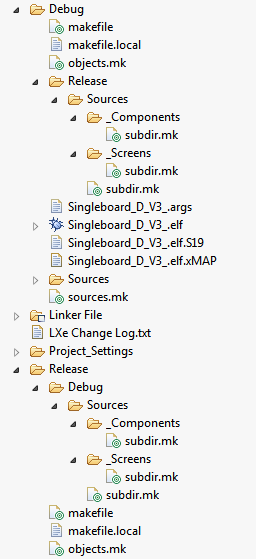

It turns out that these "extra" directories contain nothing. They do have folders in them, but every folder contains only a subdir.mk file in them. If they were eliminated entirely, it would not cause any compilation problems.
Please tell me how to get rid of them.

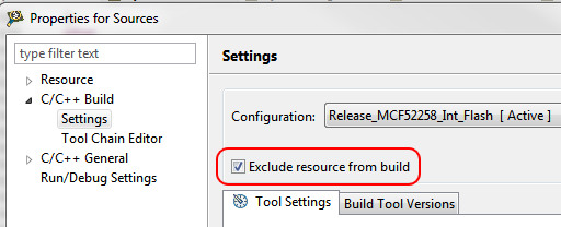

Erich,
Well I finally figured out how to stop this behavior. You may have been saying the same thing as what I found, but I just didn't understand you clearly.
The key to getting rid of the extra directories is to get rid of the extra makefiles. To do this, I need to tell CW to ignore certain files for each build target.
Choose the Release target (go to Project -> Build Configurations -> Set Active -> Release).
In the CodeWarrior Projects tab, choose the Debug folder (the Debug folder one level below the project, not the Debug folder within the Release folder). Then for the Sources directory, and the files makefile, makefile.local, objects.mk, and sources.mk, right-click the folder or file, choose Properties. Then under C/C++ Build -> Settings, uncheck the checkbox “Exclude resource from build.”
Then do the same for the Release folder under the Debug target.
Perform a clean build of both targets, and the extra folders should be gone.
Thanks to all who gave me hints at what to do.

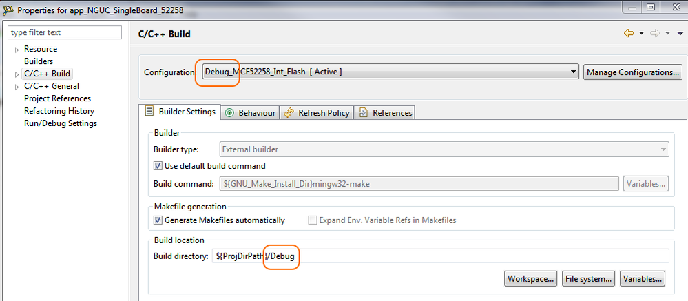

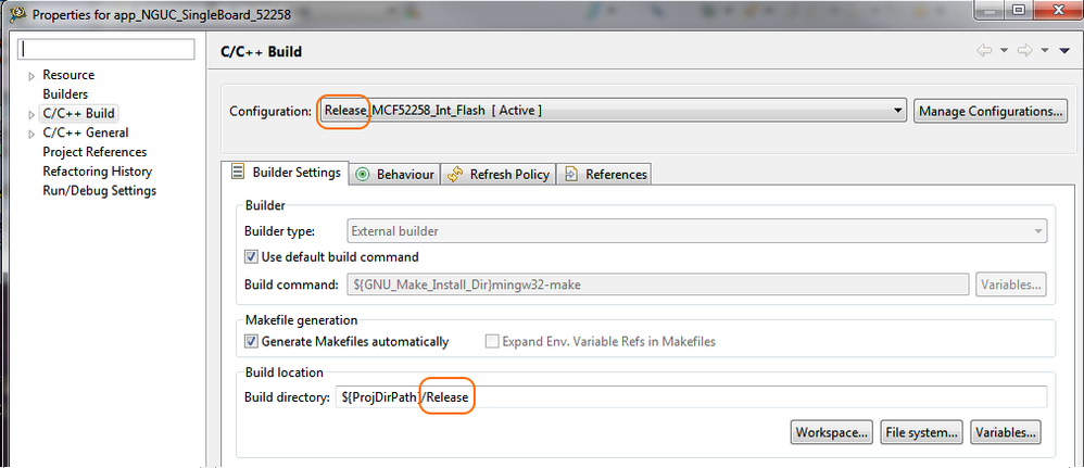

BlackNight
Hi Frank,
the path/folder for this is defined as 'Build Location' here:
Can you check your settings?
Erich
3,893 Views
frankbaird
Erich,
I have checked those. You can see the Debug target uses the Debug directory and the Release target uses the Release directory.
I've noticed that these "extra" directories have nothing in them except subdir.mk files. They are apparently being created by the Makefiles. So there is something causing the automatic makefile generation to think these folders need to be created. Any idea where this is controlled?
