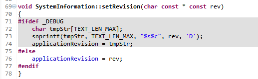

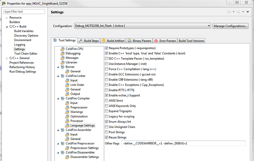

I need to be able to have _DEBUG defined in my Debug target but not my Release target. This seems to be already set up in CW, but the makefiles seem to be ignoring it.
In Project->Properties->C/C++ Build->Settings, in the Target Settings tab, in Coldfire Compiler->Language Settings, in Other flags,
I have -define _DEBUG=1.
However, when I compile the "Other flags" are ignored.
You can see this in the output below in the line starting with "C:/Freescale/CW MCU v10.6/MCU/ColdFire_Tools/Command_Line_Tools/mwccmcf".

Well I finally found the answer. The code that depends on _DEBUG was actually being compiled. However, CW was visually indicating that it was not compiled. As you can see in the image from my post from Jan 8, the code that depends on _DEBUG is grayed out, indicating that it was not compiled. That, however, is in error.
The problem arises because _DEBUG is defined in the compiler command line rather than in the code. Apparently, CW does not recognize such defines, and shows the code grayed out when it should not (and conversely shows other code as being compiled when it is not).
I would call this a CW bug, but maybe it's simply a "missing feature". I'm using CW 10.6, but I remember this being a problem with 9.2 as well. Maybe it's systemic.

I looked into this a bit more and found that the define is happening in the .args file. I did find this there:
-define __CODEWARRIOR__=1
-define _DEBUG=1
However the code that uses _DEBUG is not being compiled.
I included a screenshot so that you can see that the code depending on _DEBUG is not being compiled (it is grayed out). This occurs for both the Debug and Release targets.
