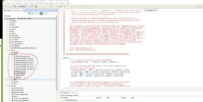

Hi Team, I am working with Code warrior development studio for DSC MC56F83789. I am using GM libraries and it was working fine. Today when I was debugging the code 4000 plus errors came related to GM Lib functions. I tried to create new project and updated the existing code however, I am receiving the same errors.
Can you please help on this ?

Pls download the library of rtcesl from the link(
NXP Embedded Software Libraries 4.2 (DSP56800E, DSP56800EX)
https://www.nxp.com/design/design-center/software/embedded-software/real-time-control-embedded-softw...
You have to create a group and load the rtcesl directory to the group, like:
Pls have a try
