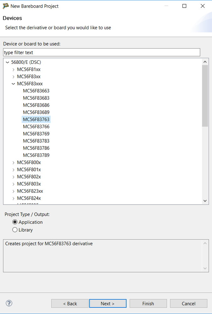

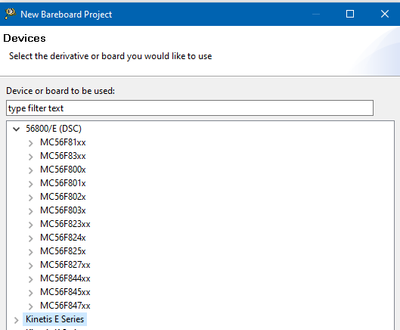

Code warrior 11.6 is not supporting/showing DSC variant MC56F83763 when I try to make a new project.
I have Checked for updates for the IDE.
What can I do to find/select this variant?

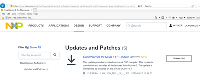

ZhangJennie
Hi fasihahmed
Please download and install CW11.1 update3 from this link
https://www.nxp.com/design/software/development-software/codewarrior-development-tools/codewarrior-l...
then you will be able to see MC56F83763 appear in CW wizard
Hope this helps,
Jun Zhang
