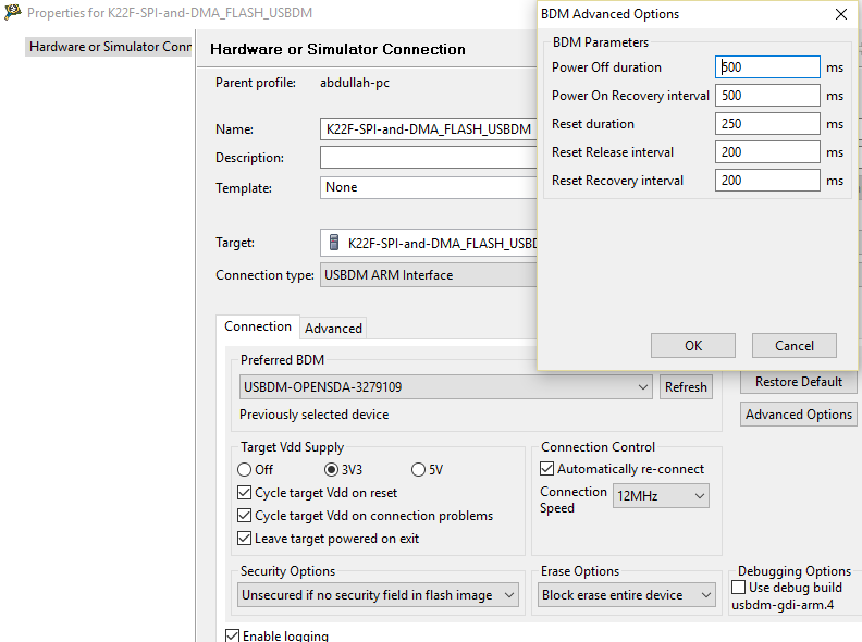

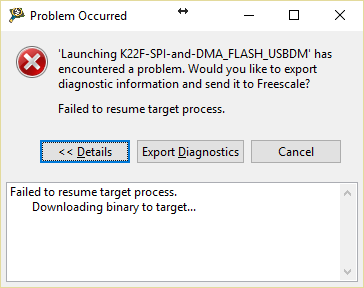

I want to debug on board K22 microcontroller on my FRDM-K22F board using CodeWarrior, however I am having this error:
My debug configuration for CodeWarrior is as follows. I cannot change "Erase Options". No matter what I select, the next time I open the dialog, it resets back to "Block erase entire device".

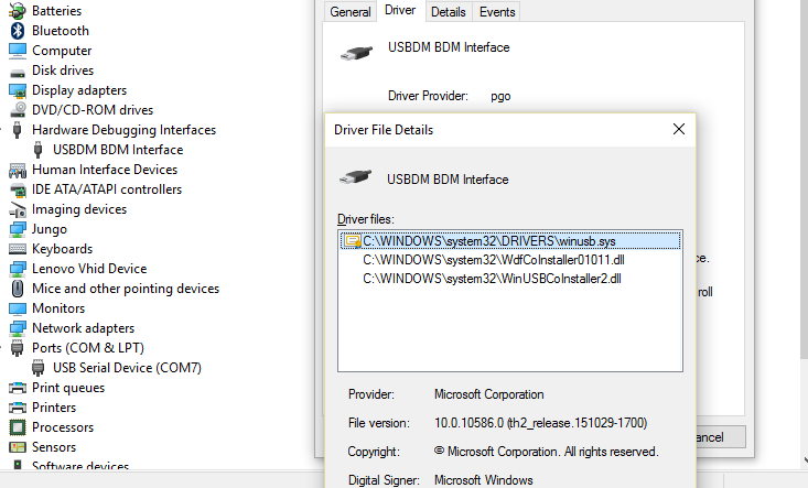

The board is listed fine in the Device Manager, as it can be seen in below screenshot:

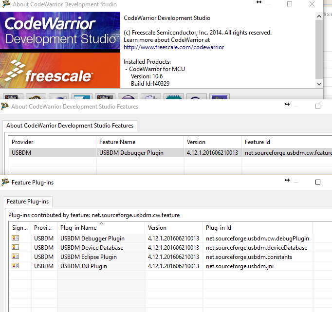

Codewarrior also shows that the USBDM plugins are installed:

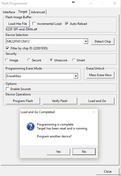

I can also, with no errors, detect, program and verify the chip using "ARM Programmer" tool of USBDM:

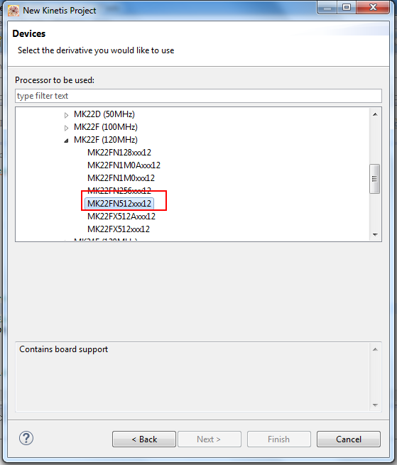

As i know  , the chip of FRDM-F22 board is MK22FN512VLH12 MCU,
while the CWv10.6 doesn't support this chip .
You can use the KDS v3.2 to develop this chip .
Please refer to this thread to download and install :
New Kinetis Design Studio v3.2.0 available
Hope it helps
