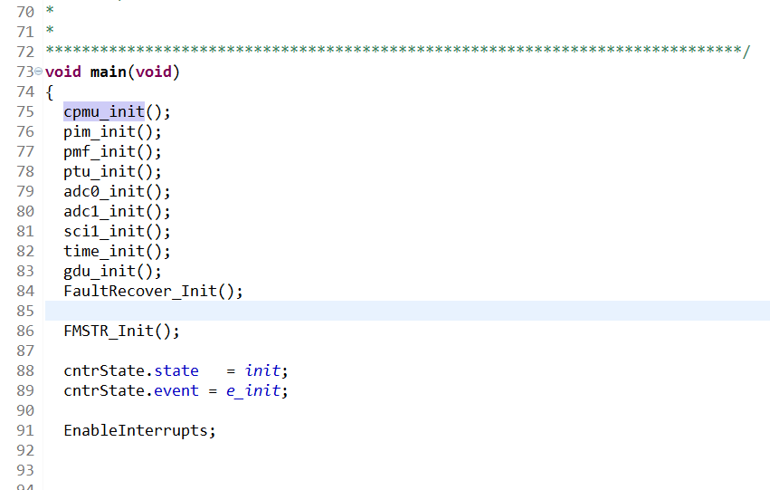

        I meet 2 questions when  I migration process from S12ZVML12 to S12ZVML31 under the guide(AN5330). The code warrior version is 11.0 and the process is SW5135.

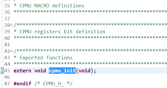

        1.In main.c , I can't open the functions definitions when i press F3 .It only jump to the exported functions in the .h files. We can see it in the following pictures.

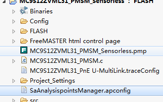

         2.How can I generate "SaAnalysispointsManager.apconfig", what's the meaning of it?

I recommend you re-build the Index (see Fixing the Eclipse Index | MCU on Eclipse ) and follow the setting shown in that post. The Indexer is kind of 'database' which is used by the 'F3' function.
The SaAnalysispointsManager.apconfig is a configuration file used by the 'SoftwareAnalysis' package which does profiling/coverage analysis. If you are not using that feature, you can ignore that file.

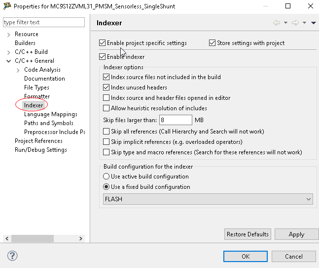

Hello  Frank,
Please try to "Enable indexer" to  as below picture, if still can't work, please delete the ".metadata" floder
under CW workspace , then reopen CW and project , rebuild .
